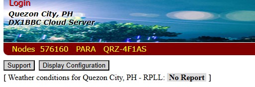

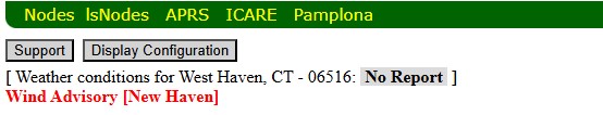

Recently I noticed that the weather data after my zip or airport code saying “No Report”. As shown on the screenshots
Any codes on supermon was changed?
