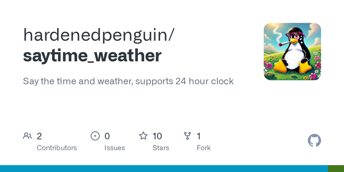

You all should stop running old outdated software. I rewrite saytime_weather for asl3 that uses the default sound files. You are adding cruft and a less then ideal audio format for nothing. I actually had to rewrite the script for Freddie as his work only supports the USA, I made sure it would work for everyone around the world even tho I don't use it. You can always find the updated saytime_weather on my GitHub page

Saytime_weather works on ASL3. Does not install correctly on ASL2. Anthing like this for ASL2?

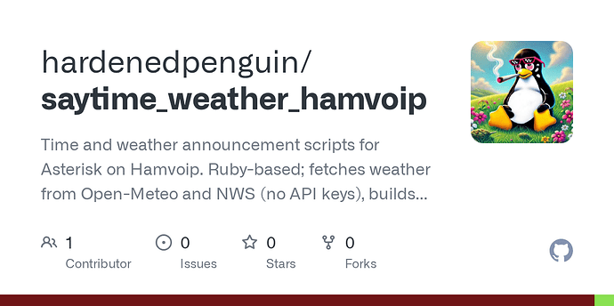

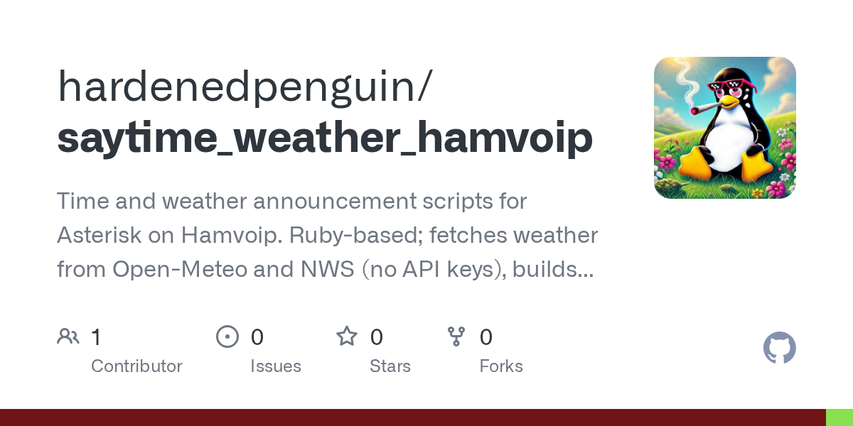

I have heard you and made the improvement. I also went ahead and ported my version of the saytime_weather_rb for hamvoip users as well, they can not have international weather support without jumping threw hoops as well.
It uses the original saytime_weather audio files so no need to do anything but install the files and update weather.ini for all the options. You all enjoy.
