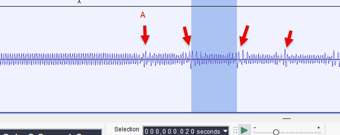

Putting one thing out there in case this helps. If I look at K9WKJ’s audio closely I can see a few things that remind me of a different problem I’ve seen.
The audio has a 1 kHz tone and also something right around 108Hz (-30dB) which I’m assuming is the PL tone? Anyhow, point A in the diagram is where one of the raspberries starts. If you look at the general shape of the distorted audio you can see 20ms boundaries pretty clearly, which is the audio frame rate of AllStar. The shaded region below is 20ms.
If I look at the spectrum during the distorted periods (all about 300ms in length) I still see the 1 kHz + 108 Hz power, but there is also a phase change and some other power around 500Hz that gets added. Those periods of raspberry remind me a bit of interpolated audio. When you are dealing with pure tones (two of them in your case), the interpolation becomes much more noticeable.
I’m not that familiar with the app_rpt architecture, but does the receiver audio get fed through any kind of PLC function? Normally you think of PLC as part of the network audio path, but is there any chance that the radio audio goes through that stage too?
