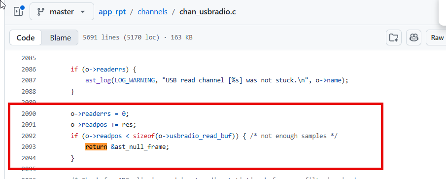

It would be interesting to find out whether the point in the code below is ever happening at one of the sites that is reporting this problem consistently. It doesn’t look like there is a counter.
If I’m reading that right, if the USB receive buffer is shy even a single sample it will quietly return a null frame into Asterisk for that tick period.
IIRC that should result in a mute frame, since that's also how asterisk maintains sync in the audio stream. As long as the codec doesn't choke on null frames, then you really shouldn't hear anything but silence at worst, as long as it's in the audio stream.
BTW, monitoring packet loss is a common method for trouubleshooting frame drop issues.
EDIT: Note that an ast_null_frame is not the same as j_random_frame with a NULL pointer.
