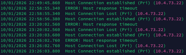

RTCM Side Log:
09/24/2026 07:40:54.800 ERROR! Host response timeout
09/24/2026 07:40:54.800 Host Connection Lost (Pri) (10.4.73.22)
09/24/2026 07:40:55.840 Host Connection established (Pri) (10.4.73.22)

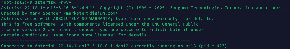

Sorry for my ignorance on this, but I've never done any ASL beta testing. I enabled the beta channel and performed the update/upgrade, however even after a restart , I still see the old version. Shouldn't this reflect the beta version:
I guess I should have read this before I tried to use the beta stream.:zany_face:
You can try devel. It PROBABLY won't break anything but no guarantees.

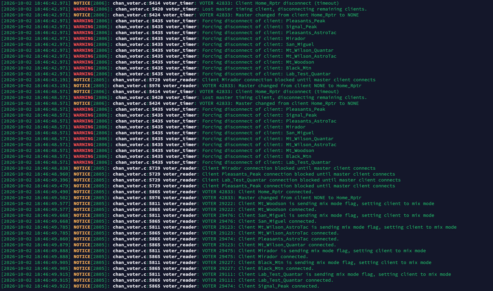

I tried devel, but unfortunately it looks like it's still happening (slightly truncated logs):
[2026-10-01 15:49:47.120] AllStar restarted and all clients connected
[2026-10-01 15:58:50.051] chan_voter.c: VOTER 42833: Client Home_Rptr disconnect (timeout)
[2026-10-01 15:58:50.051] chan_voter.c: Lost master timing client, disconnecting remaining clients.
[2026-10-01 15:58:50.051] chan_voter.c: VOTER 42833: Master changed from client Home_Rptr to NONE
[2026-10-01 15:58:50.134] chan_voter.c: VOTER 42833: Master changed from client NONE to Home_Rptr
[2026-10-01 15:58:55.491] chan_voter.c: VOTER 42833: Client Home_Rptr disconnect (timeout)
[2026-10-01 15:58:55.491] chan_voter.c: Lost master timing client, disconnecting remaining clients.
[2026-10-01 15:58:55.491] chan_voter.c: VOTER 42833: Master changed from client Home_Rptr to NONE
[2026-10-01 15:58:56.424] chan_voter.c: VOTER 42833: Master changed from client NONE to Home_Rptr
[2026-10-01 16:19:56.971] chan_voter.c: VOTER 42833: Client Home_Rptr disconnect (timeout)
[2026-10-01 16:19:56.971] chan_voter.c: Lost master timing client, disconnecting remaining clients.
[2026-10-01 16:19:56.971] chan_voter.c: VOTER 42833: Master changed from client Home_Rptr to NONE
[2026-10-01 16:19:57.143] chan_voter.c: VOTER 42833: Master changed from client NONE to Home_Rptr
[2026-10-01 16:20:02.711] chan_voter.c: VOTER 42833: Client Home_Rptr disconnect (timeout)
[2026-10-01 16:20:02.711] chan_voter.c: Lost master timing client, disconnecting remaining clients.
[2026-10-01 16:20:02.711] chan_voter.c: VOTER 42833: Master changed from client Home_Rptr to NONE
[2026-10-01 16:20:03.636] chan_voter.c: VOTER 42833: Client Home_Rptr connected.
[2026-10-01 16:20:03.642] chan_voter.c: VOTER 42833: Master changed from client NONE to Home_Rptr
[2026-10-01 16:25:57.771] chan_voter.c: VOTER 42833: Client Home_Rptr disconnect (timeout)
[2026-10-01 16:25:57.771] chan_voter.c: Lost master timing client, disconnecting remaining clients.
[2026-10-01 16:25:57.771] chan_voter.c: VOTER 42833: Master changed from client Home_Rptr to NONE
[2026-10-01 16:25:58.008] chan_voter.c: VOTER 42833: Master changed from client NONE to Home_Rptr
[2026-10-01 16:25:58.951] chan_voter.c: VOTER 42833: Client Home_Rptr disconnect (timeout)
[2026-10-01 16:25:58.951] chan_voter.c: Lost master timing client, disconnecting remaining clients.
[2026-10-01 16:25:58.951] chan_voter.c: VOTER 42833: Master changed from client Home_Rptr to NONE
[2026-10-01 16:25:59.123] chan_voter.c: VOTER 42833: Master changed from client NONE to Home_Rptr
[2026-10-01 16:26:00.151] chan_voter.c: VOTER 42833: Client Home_Rptr disconnect (timeout)
[2026-10-01 16:26:00.151] chan_voter.c: Lost master timing client, disconnecting remaining clients.
[2026-10-01 16:26:00.151] chan_voter.c: VOTER 42833: Master changed from client Home_Rptr to NONE
[2026-10-01 16:26:00.291] chan_voter.c: VOTER 42833: Master changed from client NONE to Home_Rptr
[2026-10-01 16:26:02.892] chan_voter.c: VOTER lost master timing source!!
[2026-10-01 16:26:02.911] chan_voter.c: VOTER 42833: Client Home_Rptr disconnect (timeout)
[2026-10-01 16:26:02.911] chan_voter.c: Lost master timing client, disconnecting remaining clients.
[2026-10-01 16:26:02.911] chan_voter.c: VOTER 42833: Master changed from client Home_Rptr to NONE
[2026-10-01 16:26:03.836] chan_voter.c: VOTER 42833: Client Home_Rptr connected.
[2026-10-01 16:26:03.843] chan_voter.c: VOTER 42833: Master changed from client NONE to Home_Rptr
The only thing I haven't explicitly checked is whether the Master RTCM was losing data from the GPS Receiver... but wouldn't that show-up on the Master RTCM? Below is what the MAster RTCM shows in that same time period:

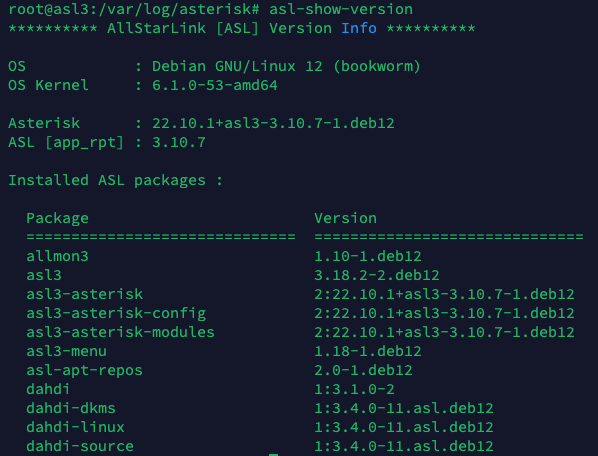

Ok, interesting. A few things here... because I am confused as to what you've got configured.
First, what does "sudo asl-show-version" show? Let's confirm you're on the right (updated) code.

Right now, if I correlate some of the timestamps, I get this:
23:20:02.560 ERROR! Host Response Timeout
23:20:02.560 Host Connection Lost
That tells me that the RTCM didn't hear ANY traffic from the host for 6 seconds (that is the timeout timer on the RTCM), so IT initiated the timeout and dumped the connection at xx:20.02.560.
That was then followed by the host responding with it's own disconnect at xx:20:02.711, since the RTCM had already dumped the connection, so it naturally hit the 100ms timeout on the host side.
When idle, the host is sending keepalive packets every 1.5 seconds towards the RTCM to keep the connection open. The RTCM resets its watchdog on any traffic it receives from the host (keepalive, audio, voter ping).

Here's the version dump:
I'm in the PDT timezone.
I truncated the log files and didn't show must of the client activity, so maybe that confused you. Here's a new occurrence of the process:
I don't have the matching log from the Master RTCM. If you need that, I'll grab another occurence when it happens.
