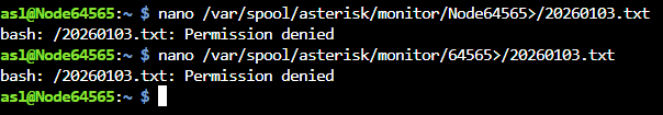

I now realize that I'm completely out of line as a "beginner"... But how do I open this *.txt file?
I do have administrative access
Use sudo nano .... or sudo -s to become root and then multiple commands.

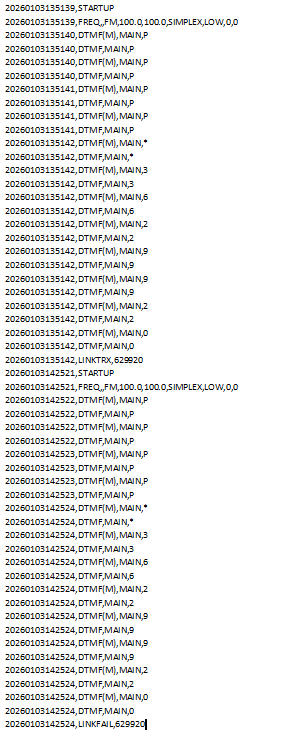

Is this the log file you meant? The last line does indeed indicate that it failed. But unfortunately, it doesn't explain why.
Your log file confirms that the startup macro is working perfectly and firing at every startup as intended, but the actual connection to node 629920 is failing sometimes due to some other issue (networking, configuration, etc).

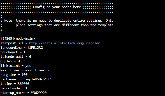

Hi Mike, thanks for your reply. Above is my (Radioless) node stanza, including the Startup_Macro.
