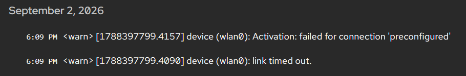

Update:
I was perusing the logs this morning and it Jogged my memory when I saw:
So, the previous night just after 6:00 PM I reset my Nighthawk WiFi router that the SHARI node connects to. I do this Maybe once a month.
I am thinking that the node went offline and never reconnected like it normally does. I would have not noticed any problem because I did not SSH to it that night and there was no scheduled nets...
I guess I may follow instructions to roll back that (fallback) feature...

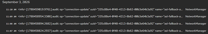

Also been noticing constant log entries every minute:
