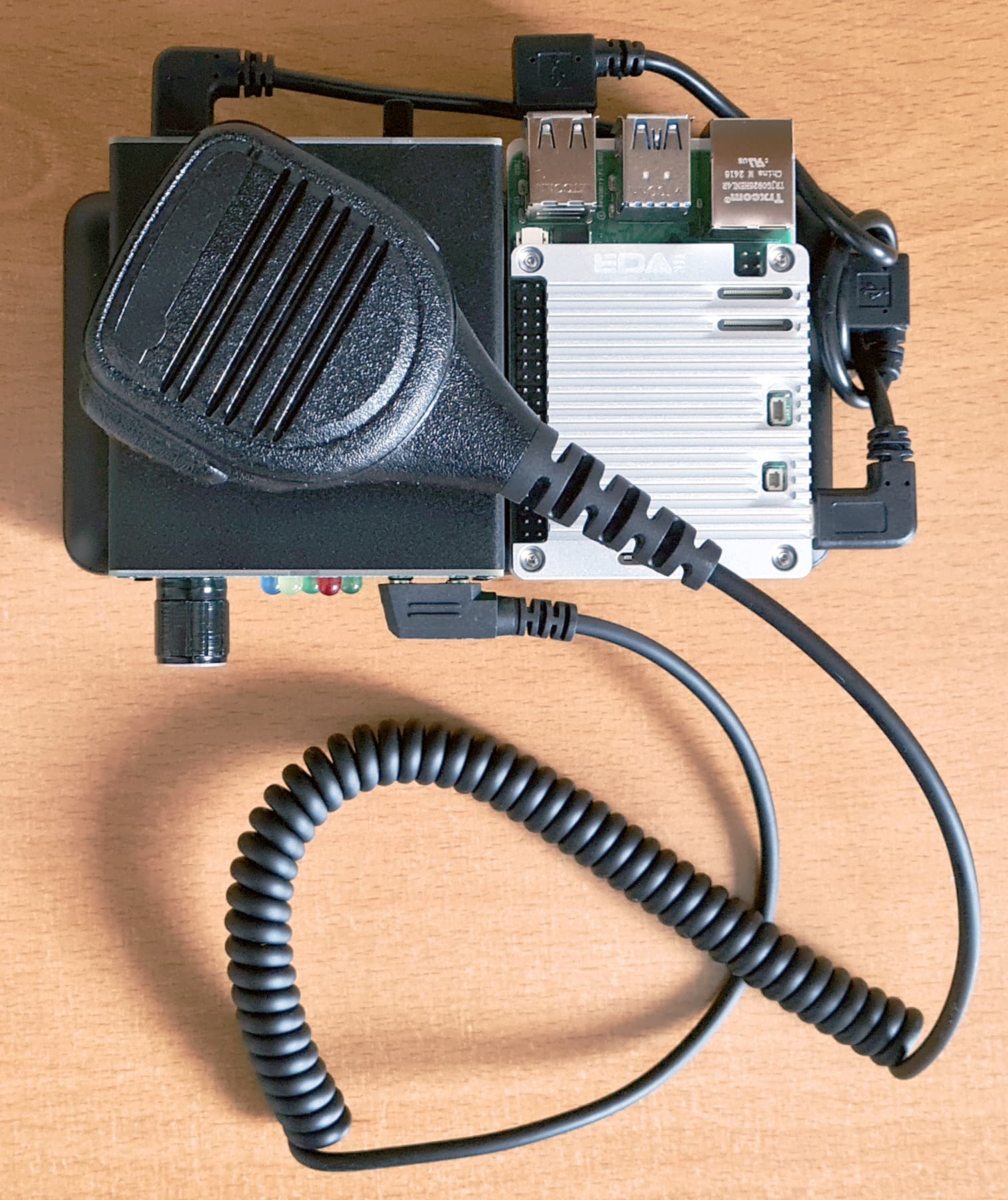

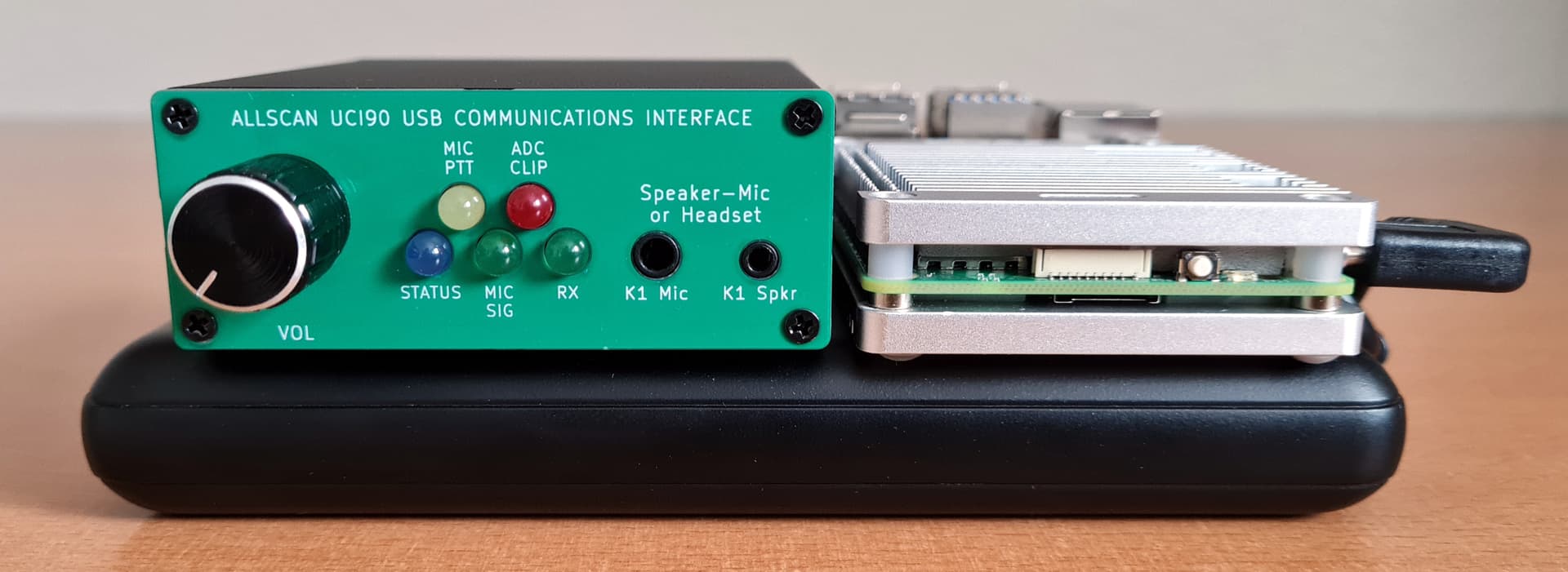

FYI this is somewhat off topic as it's more expensive than a ~$20 headset, but for high quality audio with AGC/limiting, mic gain adjustment, a real volume control knob, line out and speaker out jacks I have a new product now available - the UCI90 - that works with any standard ~$15 K1 speaker-mic or headset. See allscan.info for details. Shown below is the UCI90 with an RPi5, USB power pack, and Pryme speaker-mic. $15 Radtel speaker-mics also work well.
