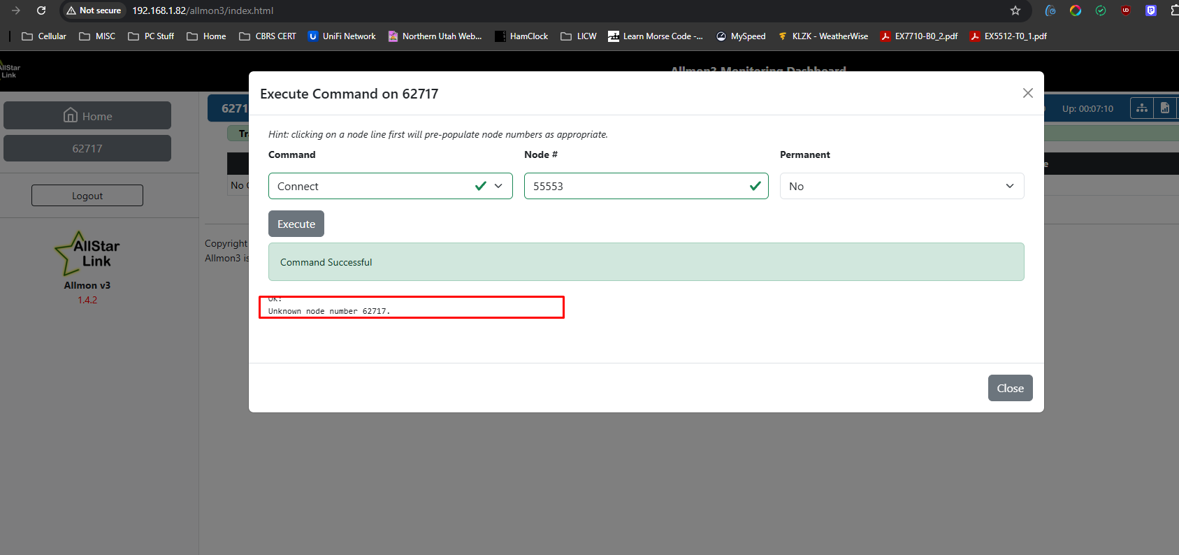

ALLMON3 Not connecting to other nodes
I am unable to connect to nodes via Allmon3
It tells me my node is unknown
I have tried reinstalling and setting up multiple times still the same issue.

I just requested another node number. Unfortunately the Help desk referred me to the community to help with the Screenshot I posted at the start of this thread. I will try and add whatever new node number they issue me and see if that solves the issue. If not I will resurrect this thread
Your screenshot is telling you that Asterisk/app_rpt is not properly configured with node 62717. Registration working or not at this stage of the game is irrelevant. Your system is misconfigured. I would suggest using asl-menu to configure your system from scratch once you have a new node number assigned.

As I said above, that error isn't that you're not registering it's that your node isn't setup right in the first place. That error is saying that locally on Asterisk/app_rpt there is no node 62717 configured. Until you fix that (or whatever successor configuration you've made) you aren't going to even be registered. Getting rid of CGN isn't going to help you with setup or registration issues. Many nodes work just fine behind CGN when using IAX2 registration.
