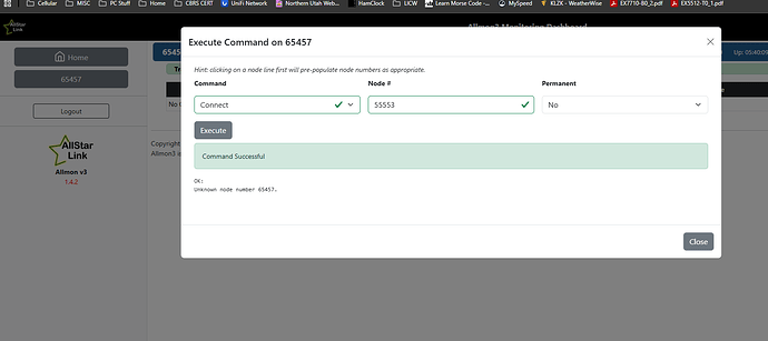

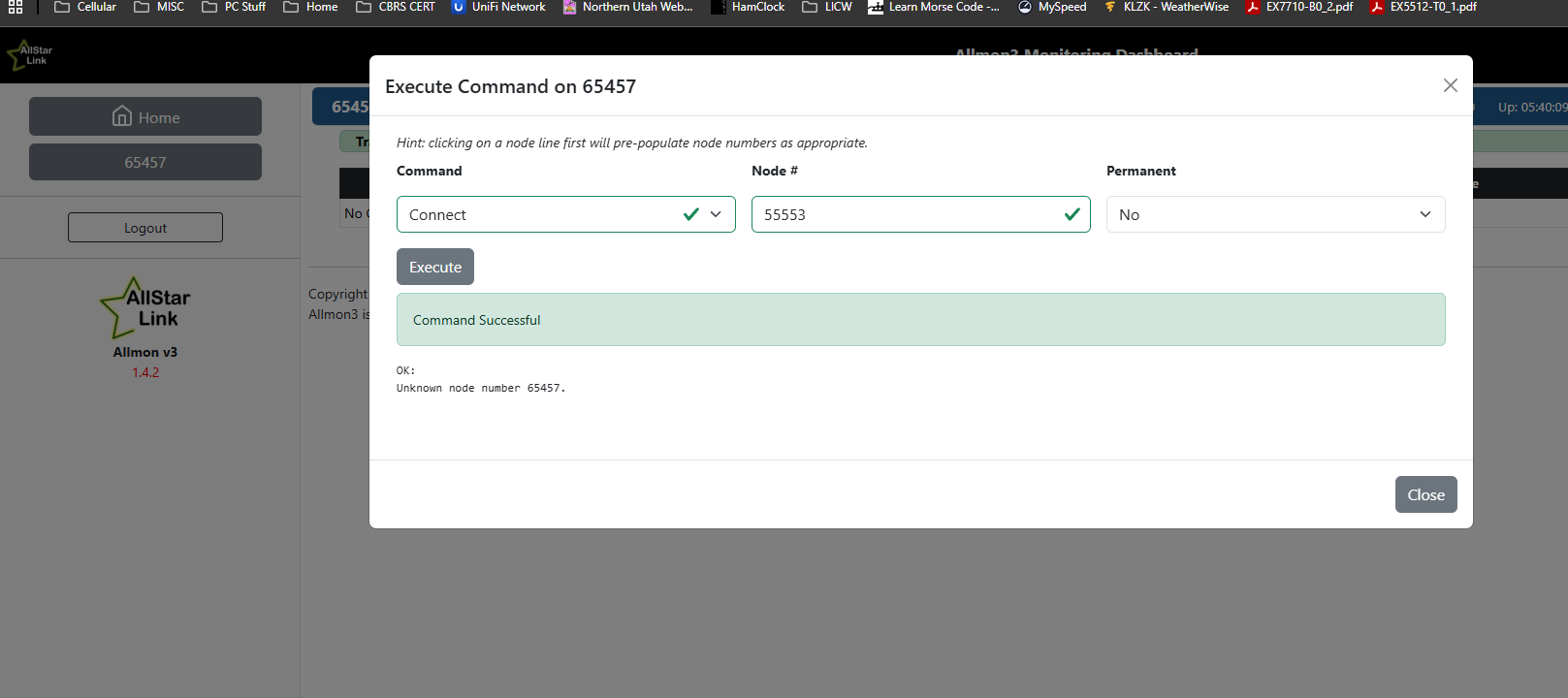

All Mon is showing the correct node number now and not allowing connections still.
What can I use in place of Allmon3?
At time of posting, I could not connect to 65457 as well.
Perhaps post your extensions.conf for some extra eyes
Folks..... this is not an Allmon3 issue, it's not a registration issue, and it's not an extension issue. The system is not starting up an app_rpt for node 65457. That error is just showing the response that you'd get from the Asterisk CLI if you ran the same command there.
The core issue is that app_rpt doesn't think 65457 exists. Since that's the case and this is a pseudo/dahdi type node according to rpt.conf then that means that something with the install is messed up and, most likely, the DAHDI kernel modules are not loaded.
