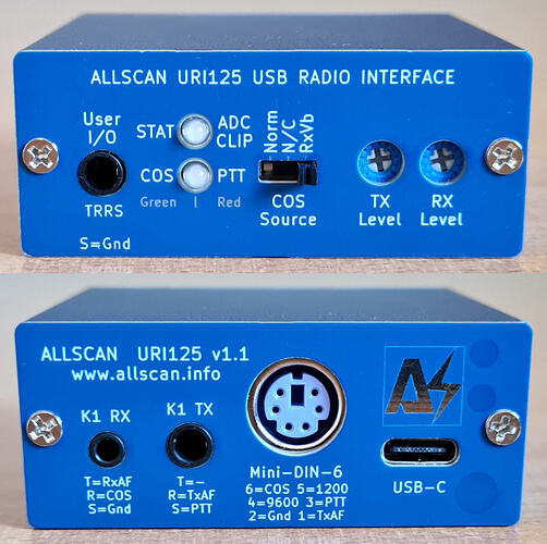

The AllScan URI125 is by far the highest quality and most cost-effective interface for any radio with a Mini-DIN-6 jack.
https://allscan.info/products/#URIs

Hi, can I know the main difference between version 1.0 and 1.1? tn
ks
v1.1 is the current version, 1.0 is no longer available. The only significant difference is that in v1.0 the COS Source switch was on the interior; in v1.1 I moved that to the front panel.

I’ll give a try to AllScan URI125.
