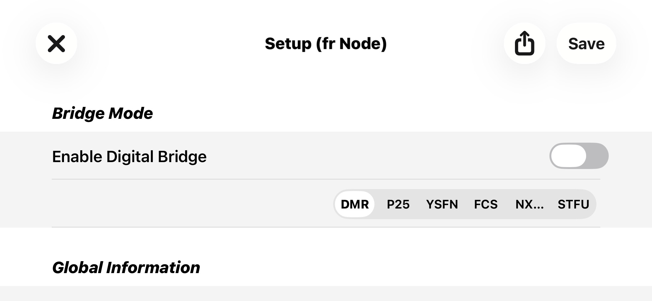

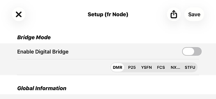

I am running AllStar and Echolink on a DR2X via a NodeVentures ClearRpt. Since it connected to the same connection as the HRI-200 I parted ways with Wiresx. I have not taken the next step to turn on the digital bridge available in the ClearRpt
you answered my question what cable do I buy from node ventures to do the same you have done with your dx2r kq4upk
