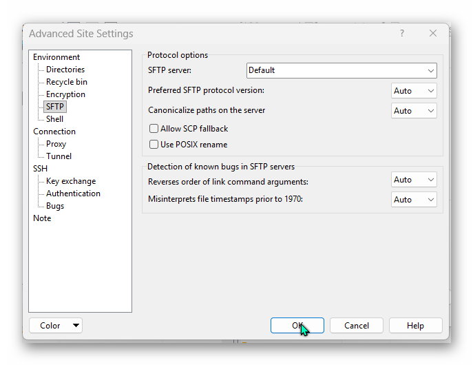

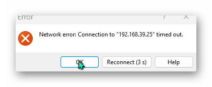

Raspberry Pi 3b. Followed Appliance install, then node setup, then restart asterisk. Open WINScp. As instructed, File protocol SFTP. Host name is local IP address. Port set correctly. User name correct. Password correct. ADVANCED: SFTP server=default. LOGIN, searching for host, Network error: Connection to xxx.xxx.xxx.xxx timed out.
Fixed! Systemctl status ssh showed port 22, which DOES work. Guess I still have to change to our desired port.
