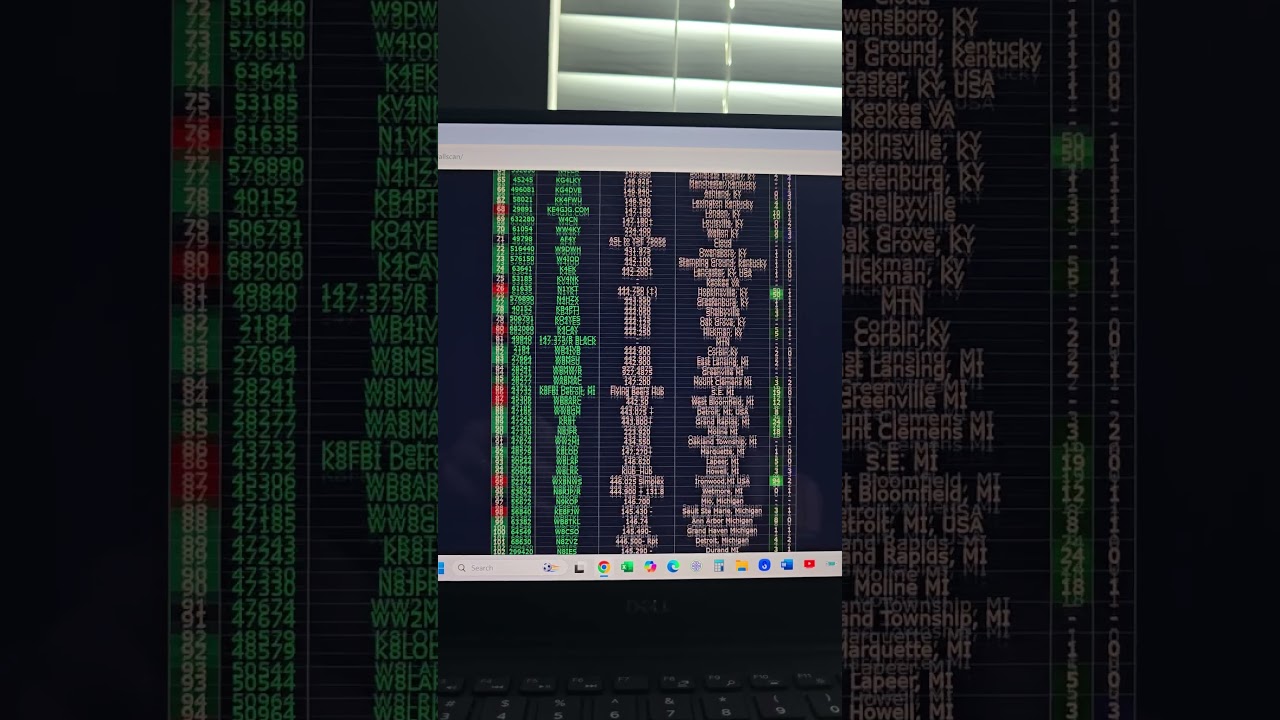

I enjoy making my own favorites lists in AllScan. I recently made a favorites list of all ASL repeaters in my home state of Indiana and the surrounding border states of OH, KY, IL and MI, 134 nodes in total. Allscan requires about 5 minutes to scan the entire list. This is certainly not a rapid process, but fast enough to report on somewhat recent node activity.

When you say "scan," are you referring to audio scanning of the different nodes, or are you talking about updating the data in the columns on the right side?
Updating in the first column and right two columns. Not audio scanning, just updating activity for each node.
