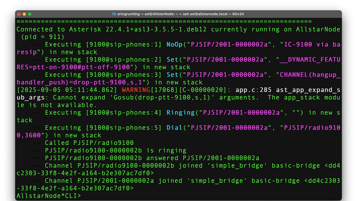

You should be able to use a SIP client like BareSIP. Since you aren't going to be using repeater audio to send out to the Flex, there's no need for COS or other signals. I've used it with my Icom IC-9100 over the USB audio interface. I had to set up some scripts to key the mic - *99 and # to send PTT over CAT but it works fine.
