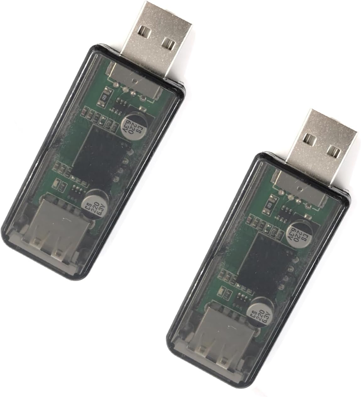

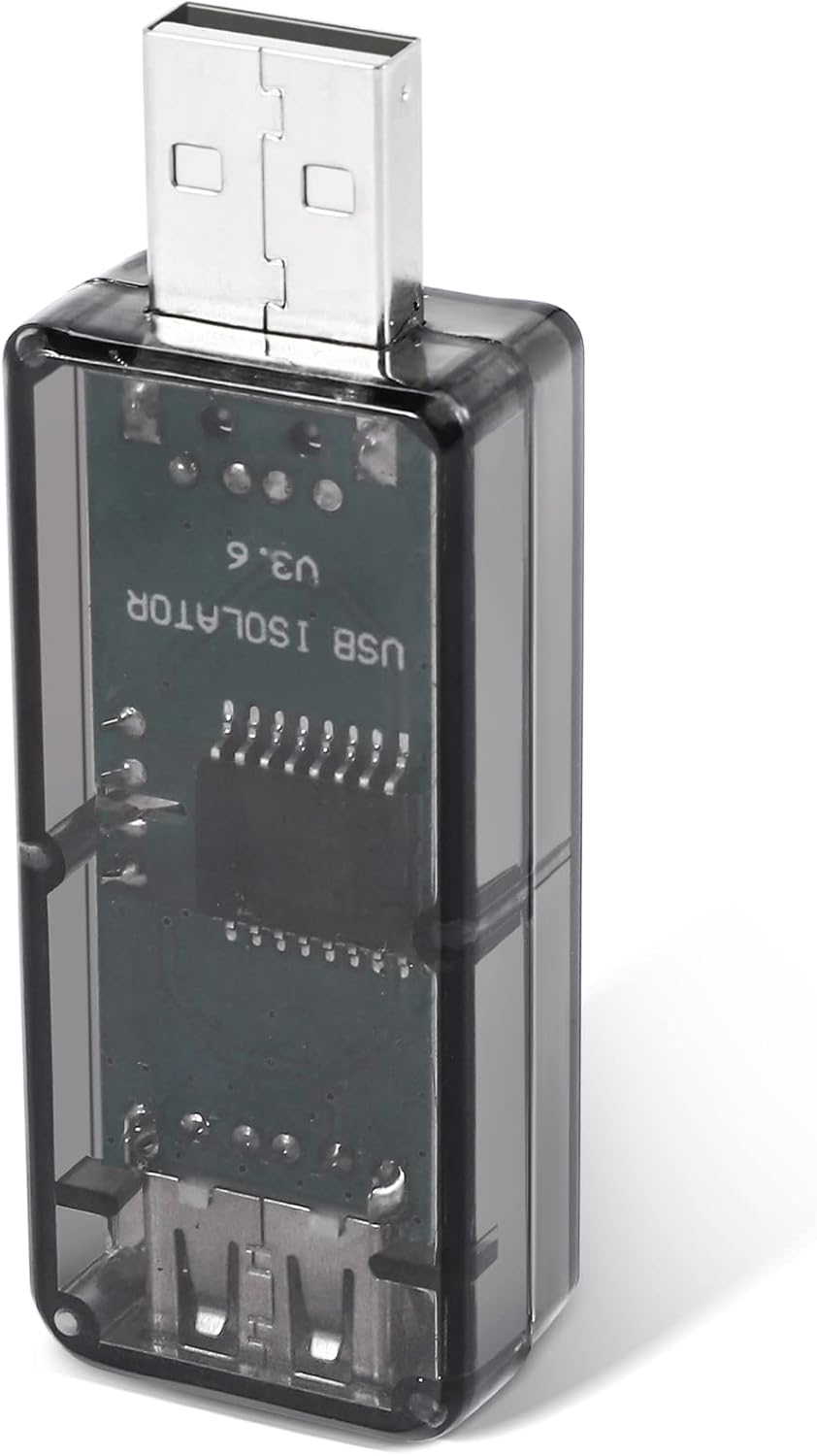

not all of the ADUM3160 boards are alike, though. there is one presently available via Amazon where clearly the time was taken to route the input and output board traces away from each other, leaving a central isolation zone.
What AADUM3160 did you use? All the ones I have looked at have said does not work with audio devices.
I think they may be talking about like professional audio recording interfaces and not sound cards as the speed and amperage is very limited. It looks like some of those that I have seen that as well.
if what you are looking at to purchase looks like this, you're good to go..
