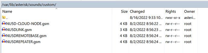

No Unkey CT in the 2nd stanza did not fix - Image (screen shot) of directory tree - same file and location plays for ID…
You have 2 different file locations mentioned. I assume the file is in…
/var/lib/asterisk/sounds/custom
You said the id recording plays
idrecording = custom/NU5DLINK
and it is fine. That is because Asterisk looks in the default sound directory for a directory called custom for the file.
But you say you’re sending…
rpt localplay 559821 /custom/NU5DLINK
With the / before custom your tell Asterisk not to look in the default directory but to start in root and look for the custom directory which it can’t find so it fails.
/custom/NU5DLINK looks in…
/custom/NU5DLINK
/var/lib/asterisk/sounds/custom/NU5DLINK
custom/NU5DLINK
/custom/NU5DLINK
Are 2 different things.
I could be wrong but I think removing the leading / should fix your problem.

Tony - that did the trick - big thank you - I sure have lots to learn and very grateful for everyone being patient with me. 73, steve
