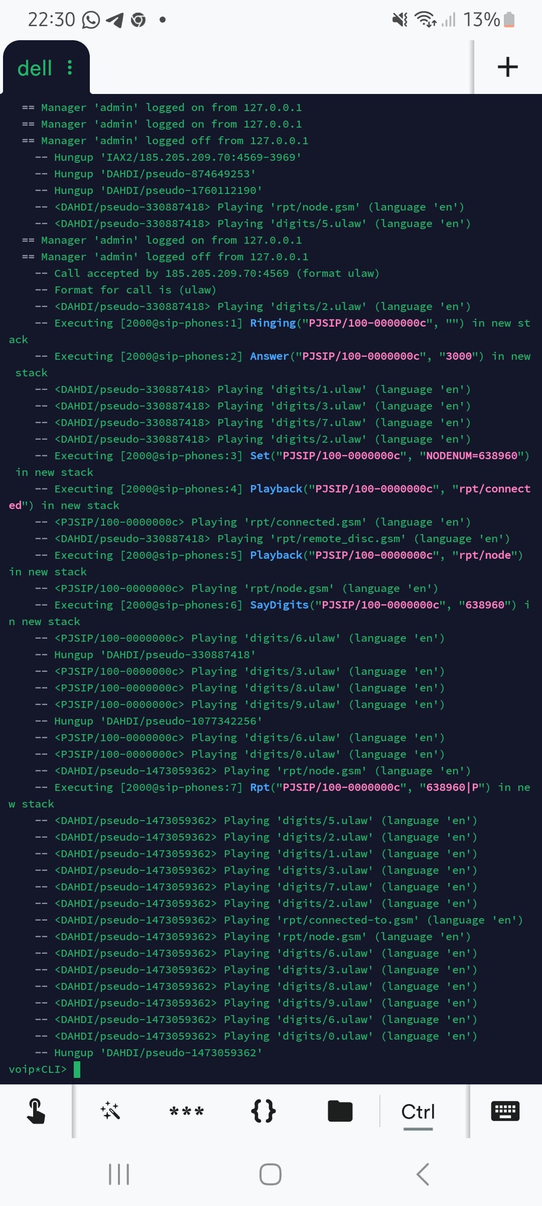

I run sudo asterisk -rvvv and i see this
The phone is outside my lan

Hi, to me, it seems all fine with CLI test.
What do you think?
