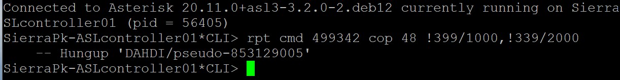

If I enter the following in the Asterisk CLI (accessed from the ASL Menu) I get a successful tone set: rpt cmd 499342 cop 48 !399/1000,!339/2000

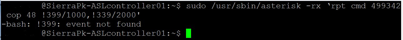

I can set the same up as a function in rpt.conf. However, when executed from the Linux command line, I have no success, regardless of the type of quotation marks.
For example, if I enter the following at the Linux command line:
sudo /usr/sbin/asterisk -rx ‘rpt cmd 499342 cop 48 !399/1000,!339/2000’
The result is: -bash: !399: event not found

This works:
This does NOT work. Look at the output.

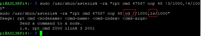

Just a thought. If you use !2 instead of !399 I wondered if you then get the same symptoms as I did. The !XXX was retrieving prior commands issued on the command line. So !1 is the last command and !10 was the command issued 10 lines ago. It might line up with the ‘event not found’ message.
Try this test with both double and single quotes. In the example below, I used !3 and !4.
