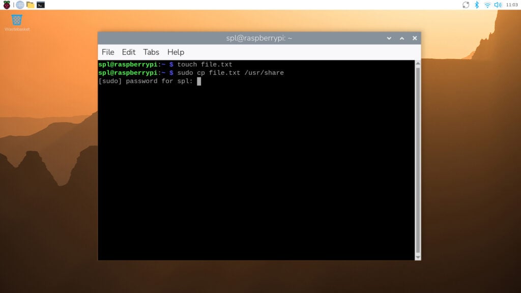

When clicking administrative access, it prompts for a password.
When at the command prompt sudo prompts for a password.
The reason is the file /etc/sudoers.d/010_pi-nopasswd is missing along with the data that should be in it. Restoring the file and its contents fixes the issue.

"We" haven't made any recent changes to the ASL3 packages or our image creation process targeting password-less "sudo". I will need to research if any of the base packages have been updated.
Is it a desired change? If you are trying to keep your system secure then it's a good thing. Some are willing to accept the added risk, others not.
This was an intentional change from upstream that appeared in 6.2 (Trixie second release from RPi). We follow upstream.
