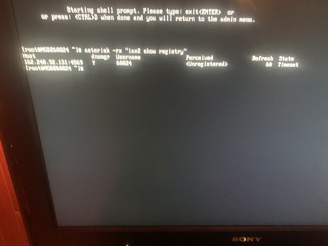

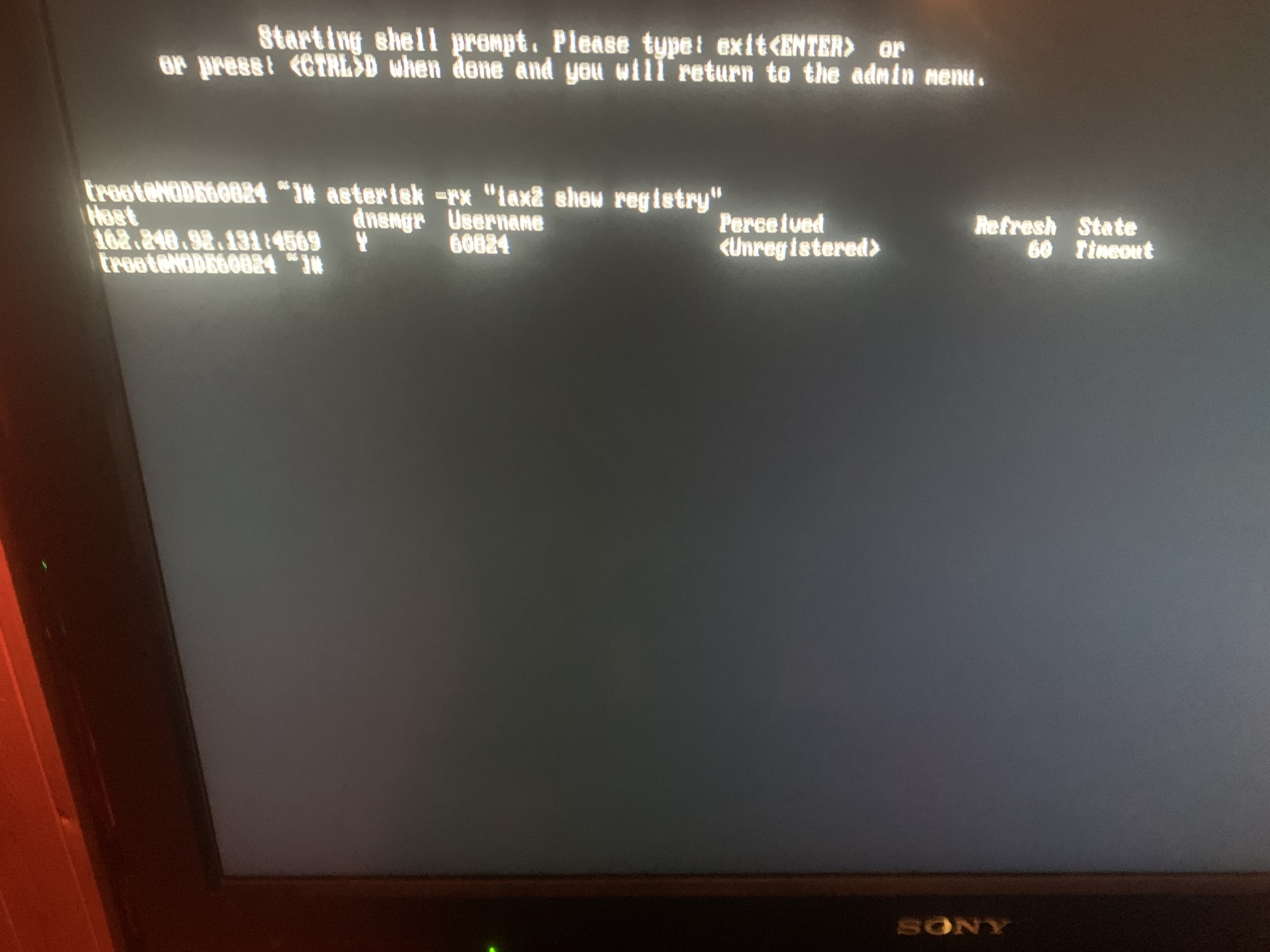

Thanks so much for the reply, I really appreciate the help, I am able to ping both registration servers (the main one and I tried west) and the return from the ping is fine, but it gives me this :
And the web portal , node settings … it says Registered “No” , so I don’t imagine anything will connect just from that. But this account has been working just fine for months, I don’t know why that suddenly changed to not registered. I had tried changing to password to see if that fixed it but no luck there , and I have reverted it to the original one. All passwords Match in the iax.conf . I’m not the most computer savvy operator out there, so if there is somerhing specific or output from something that would help please let me know . The pi has been rebooted several times and that’s not the fix apparently. When I re-run the show registry command , state changes to “request sent” for a few and then change back to “timeout” (it will only let new users post 1 pic) .. Thanks again !!
Looking at the database and the logs, it's not failing registration so much as your node doesn't seem to be trying to register at all. There's no attempt for node 60824 to register since it's last successful registration on 2025-05-24 18:40 UTC which is well after the problem with register-central. From your screenshot, it looks like you're using HamVOIP which has a grafted-in parallel system so that could be the problem? I can't help with HamVOIP.
