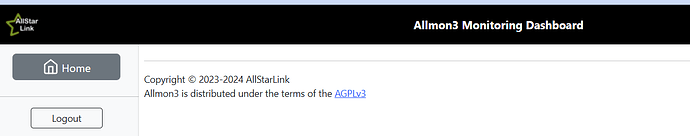

I installed ASL3 on an Intel NUC 2gb/32gb with Deb 12. I have setup a couple of nodes with both the image and Debian. This time, when I go to the IP address, the landing page is absent. If I go to allmon3, it shows the page, allows login, but shows no boxes at the top to link, etc. I Installed Supermon 7.4 and it works just right.... I will probably do a re-install, unless there is a quicker fix for this.

I installed allmon3, configured it set a password. I can bring it up, log in to it, but the selections are missing...
What does the output of ‘journalctl -u allmon3’ say? Looks like a configuration issue with allmon3.ini.
