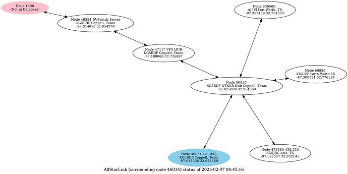

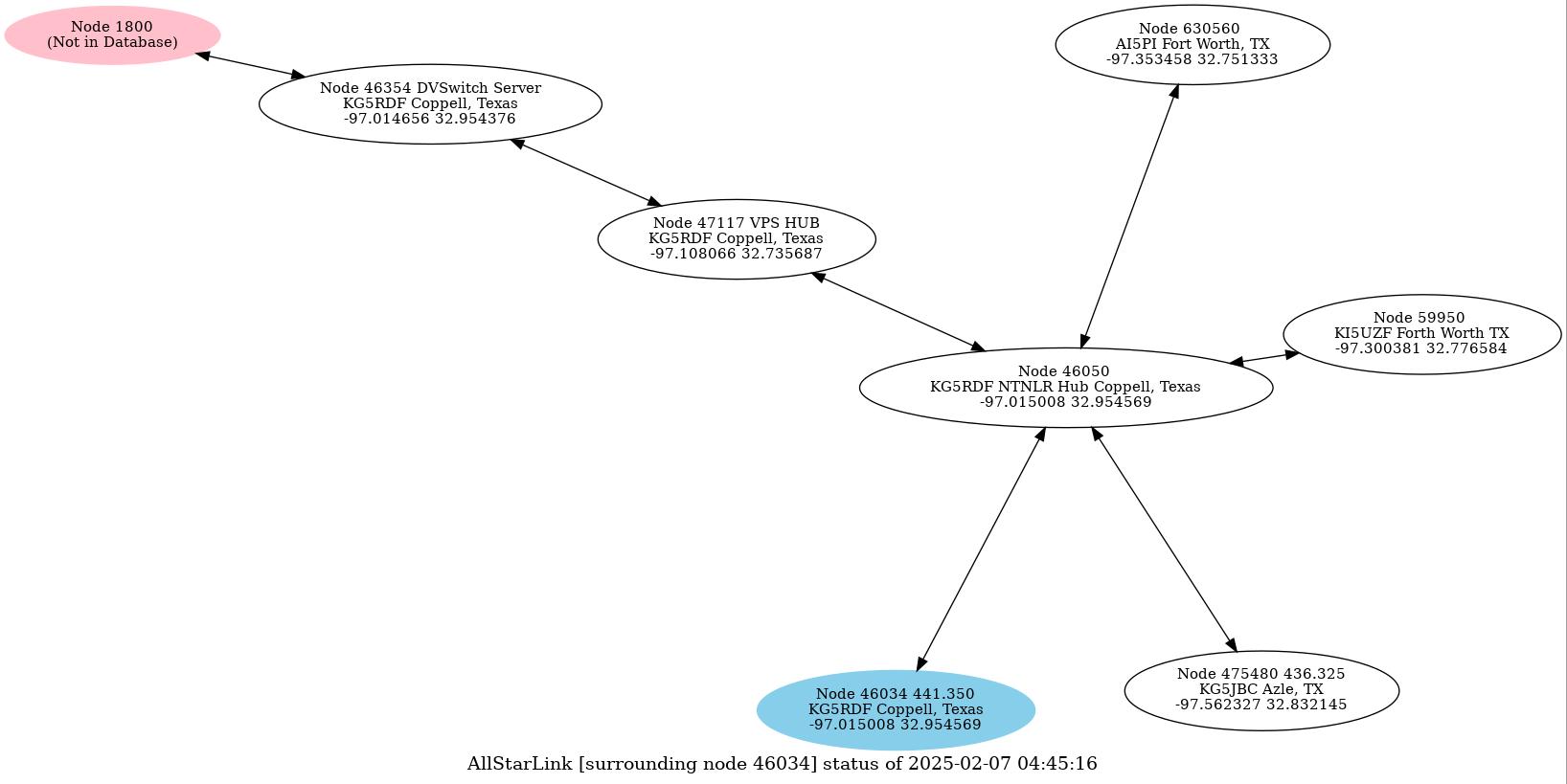

Any ideas why this is happening? It is reporting fine though.
