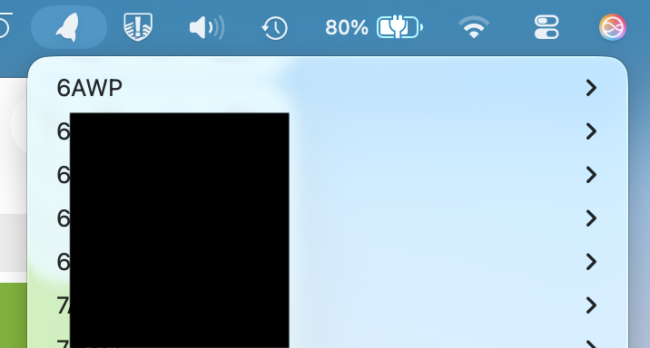

I use a Mac App called Shuttle. Shuttle | A simple shortcut menu for macOS. It sits in the menubar providing a list of all your hosts like so…
It reads the .ssh/config file for your ssh settings. It’s very handy
Here’s an example config. Note the forward slash provides organization of your systems as seen above.
