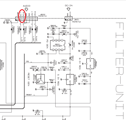

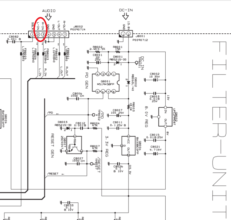

I think that if you feed direct discriminator audio to the usb interface and use usbradio then it automatically takes care of the necessary delays and avoids loosing any audio in the process. For best results you can grab the direct discriminator
audio from the cable that runs from inside the Receiver Unit to the Filter Unit (shown below), I can’t remember if I used the L-in or the R-in. Or second best you can use the DSP processed discriminator output in the DB15 connector (center pin in center row,
pin 8) but it isn’t as good and has more delay.
can grab the direct discriminator audio from the
center row, pin 8) but it isn’t as good and has
more delay.

<image001.png>

<image002.png>
the process. For best results you can grab the direct discriminator audio from the cable that runs from inside the Receiver Unit to the Filter Unit (shown below), I can’t remember if I used the L-in or the R-in. Or second best you can use the DSP processed
discriminator output in the DB15 connector (center pin in center row, pin 8) but it isn’t as good and has more delay.
<image002.png>

I can’t speak to the specific hardware you’re running, but the latency problem if growing seems to be inherent to the audio interface.
I’ve seen it happen on the pci buss type systems before, as well.
Back to the squelch crash, I think using the usbradio channel and letting the DSP decode ok.
Thank you Geoff
I am going to maybe try that maybe using the discriminator audio from Pin 8 on the DR-1x with USBRadio.
John de KE5RS
