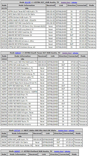

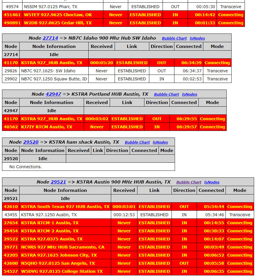

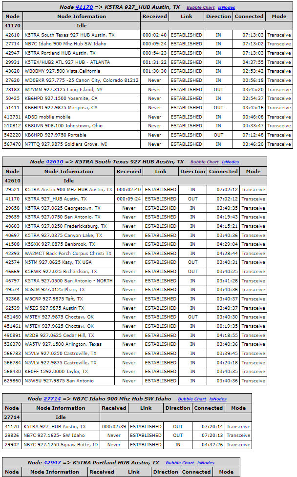

Some of my hub connections displayed as "connecting"
Today, I'm seeing some of my hub connections displayed as "connecting" (rather than connected) on Allmon and Supermon. The nodes are in fact connected. This just started today. The hub server is a Dell I7 running Debian 12 / ASL2. Any ideas??

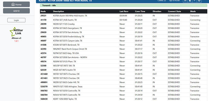

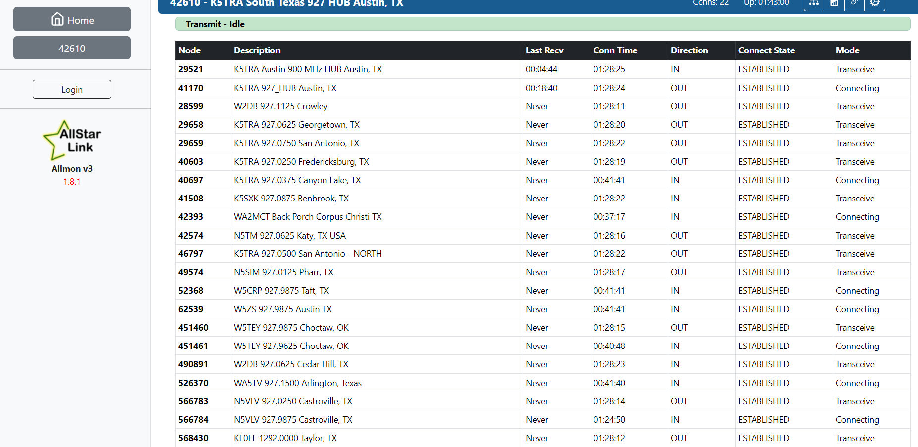

Here's some of what I'm seeing:
On the chance that this was due to the older Supermon 6.2 or Allmon2, I installed Allmon3 and get the same "connecting" result on many nodes. Here's a look at
one of the hubs (42610):

Today, I'm again seeing this "connectiong" mode in Allmon and Supermon for nodes that have the link "Established".
