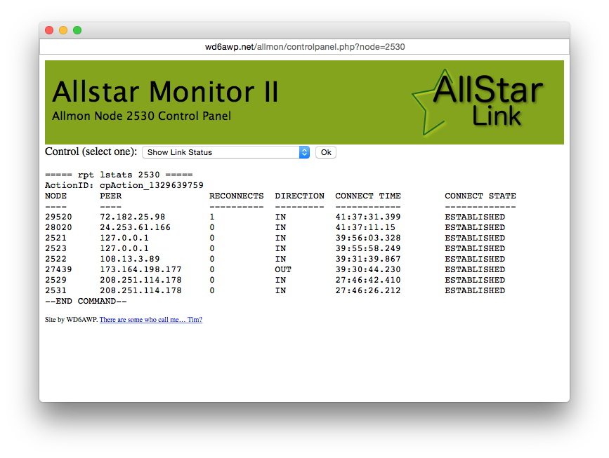

or with rpt lstats <your-node_number>
Allmon looks like this…
Tim

Yes, Allmon is certainly another choice that I think would give you what you want.

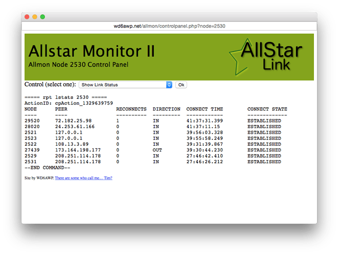

Tim
