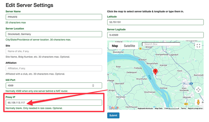

Server Settings: "Proxy IP" is not being used at all?
I have an Allstarlink Server (Raspberry Pi with the official Image) running inside a network which
can’t have/does not support port forwarding. So what I did is settings up a proxy server for UDP port 4569 on a server in the Internet (IP is 65.109.113.117 as shown in the screenshot below).
When I directly connect to this IP on port 4569 with my SharkRF M1KE it works perfectly.
However, in the list of nodes/servers, when I select my server (DO1MJ), a different IP address shows up (probably the external IP of my home network) and not the Proxy IP I configured in the server settings. It seems like this setting is not being used?
What can I do to solve this?

Specifying a proxy IP for a server, and then associating one or more nodes to that server, will cause the proxy IP used in the connection database rather than the 'discovered' IP address. Calling it a "proxy" is incorrect nomenclature. It's basically "My IP is always this regardless of what the registration servers see". It's only useful/functional in a very limited set of advanced circumstances.

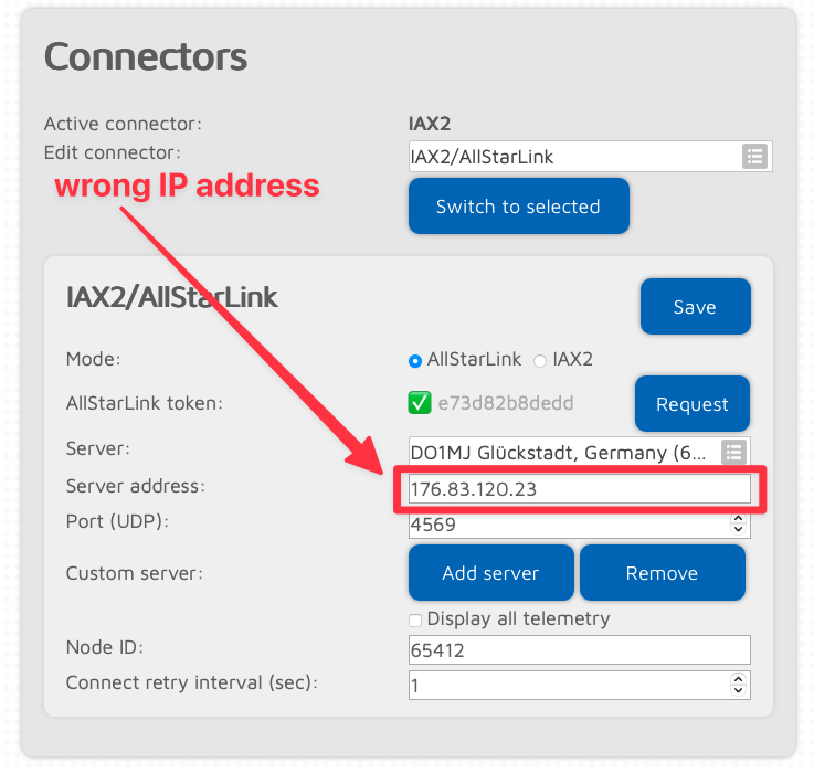

Sure. With my SharkRF M1KE, when I connect to my Node DO1MJ (65412), the IP address in the node list is the one shown in the image. My expectation would be that the static configured "ProxyIP" (65.109.113.117) is returned but it seems it's not. You can try it yourself. Search for "DO1MJ" in the node list and when the IP address of the node is not "65.109.113.117" it's not the correct one.
I'm not sure what app you're looking at there but the AllStarLink database is returning 65.109.113.117 for node 65412. That is what is configured in the ASL portal for your server labelled "PRIVATE" and what's in the DNS and file databases:
$ dig +short 65412.nodes.allstarlink.org
65.109.113.117
$ wget -O- -q https://snodes.allstarlink.org/diffnodes.php | grep 65412
[email protected]:4569/65412,65.109.113.117
Hello, thanks, that was exactly the answer I was looking for.
So it seems like it's a problem with the SharkRF M1KE device which does not update the database frequently enough or delivers a false response.
Thank you, I'll contact the SharkRF support.
Ah okay... I've never seen a SharkRF so I didn't know that's where that window came from.
