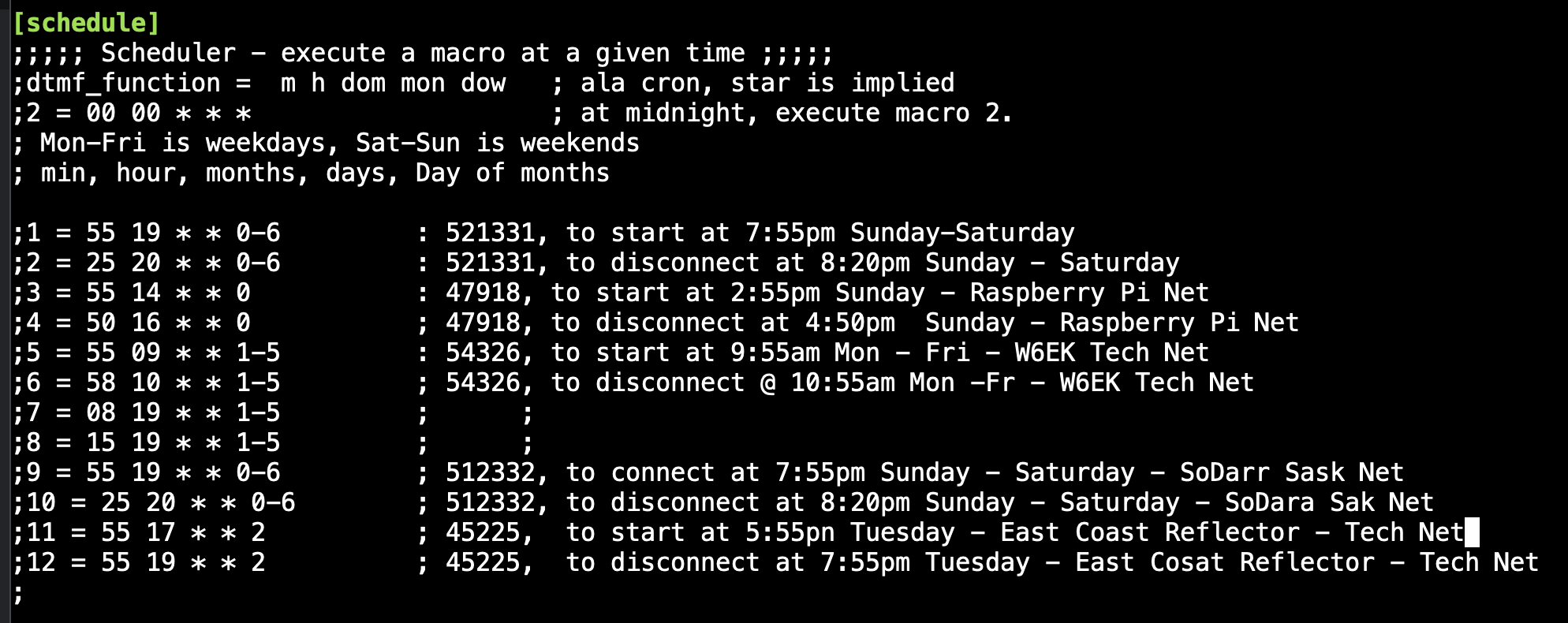

Second, lets look at the Scheduler. In HamVoip anyway, I cannot get any scheduled tasks to run when one of the cronjob settings contains more than one character, ex. * * * * MON-FRI, or 1-5, or even 1,2,3,4,5. This could be a bug in Allstar general, I don’t know.

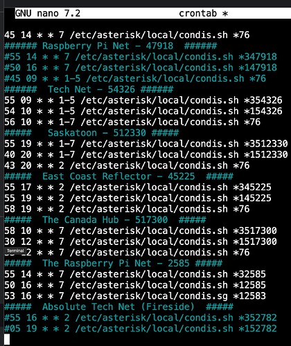

I would suggest running “crontab -e” and adding the scheduled task there so there can be no question that it will work. (Adding it here as a system cronjob also eliminates the need to run a rpt reload or astres.sh command to reapply the changes made to the rpt.conf file).
Lets look at an example you could add to crontab -e to run your Macro 1:
55 19 * * * asterisk -rx “rpt fun *51”
Macro 3 would be:
55 14 * * SUN asterisk -rx “rpt fun *53”
(Alphas must be in ALL CAPS, or just use 0 for Sunday)
You might want to run a test job by creating a job 5 minutes past your current time, then wait for it to run to make sure it works.

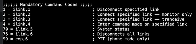

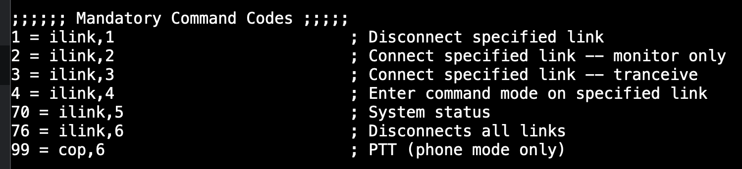

Note: If the *76 disconnect string doesn’t appear in the [functions] section of rpt.conf, then add this first:
76=ilink,6 ; disconnect all links

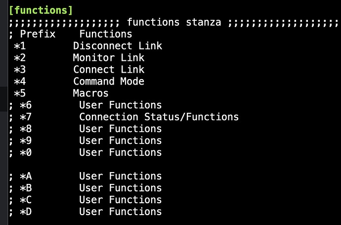

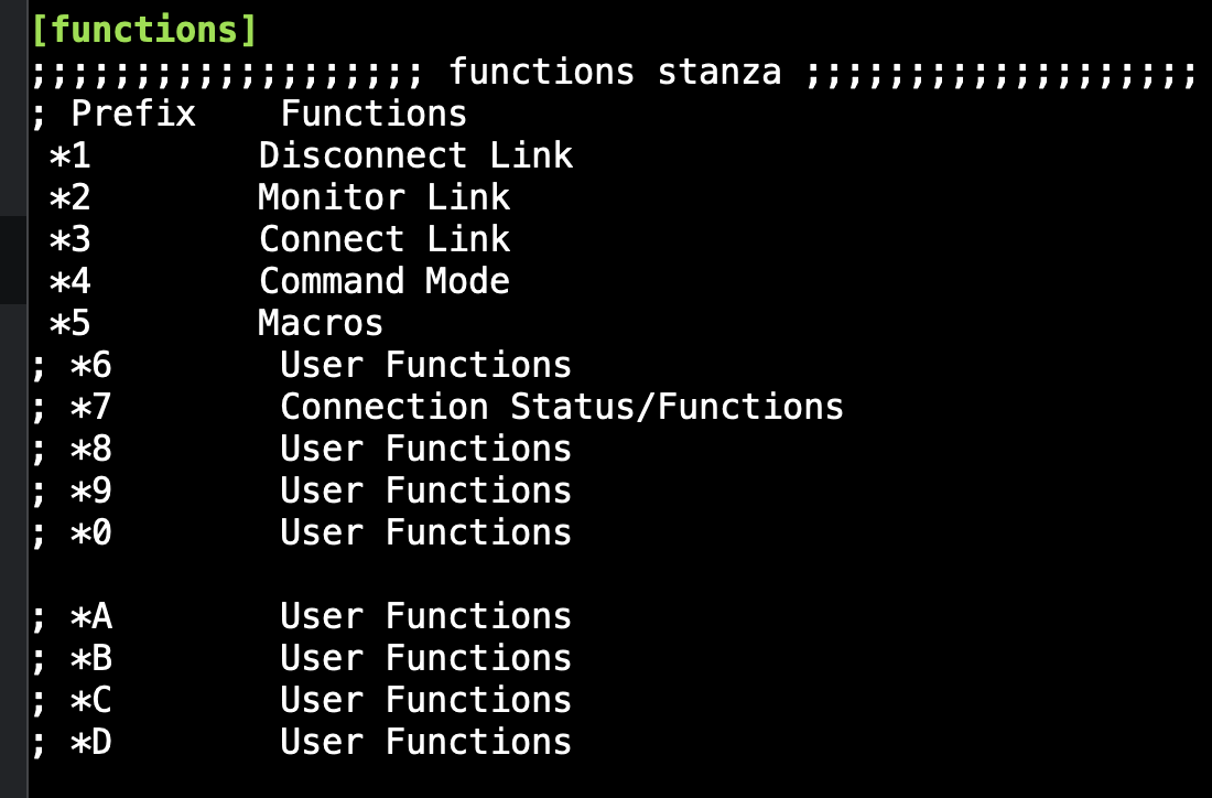

The ASL equivalent of *76 in HamvoIP is *806, but it’s commented out in the function list by default in ASL3, I guess to prevent random drive by disconnecting of all nodes.

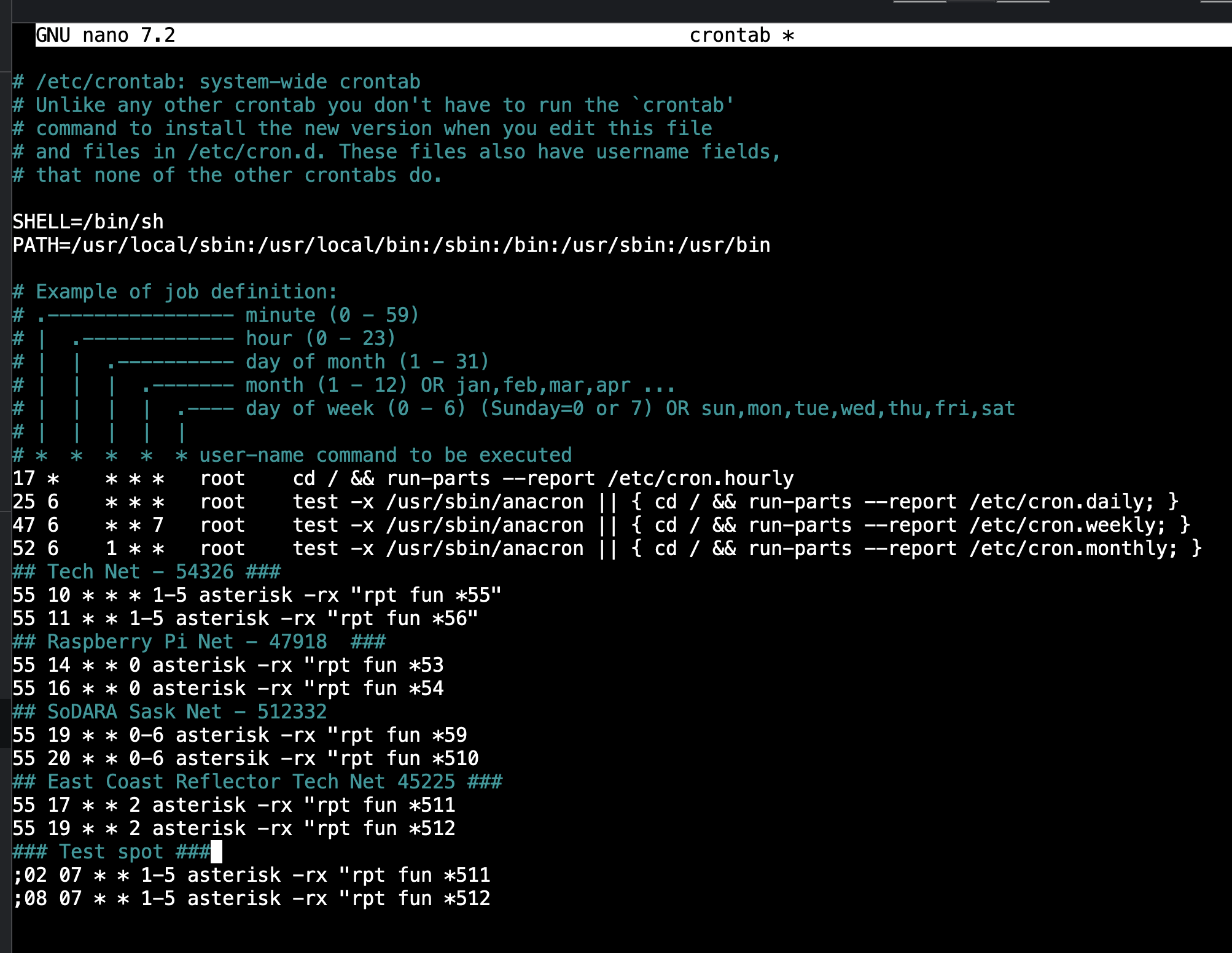

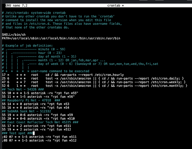

Good morning Jim
I tried the Crontab -e, that disnt work.
I did put that 76 in but when tx from supermon it disconnects right away.
Here some updated screen shots:
Got my Time and Scheduler to work with help from KD5FMU Freddie Mac on Youtube hamradiolife.org
This is for ASL3
Debian Bookworm

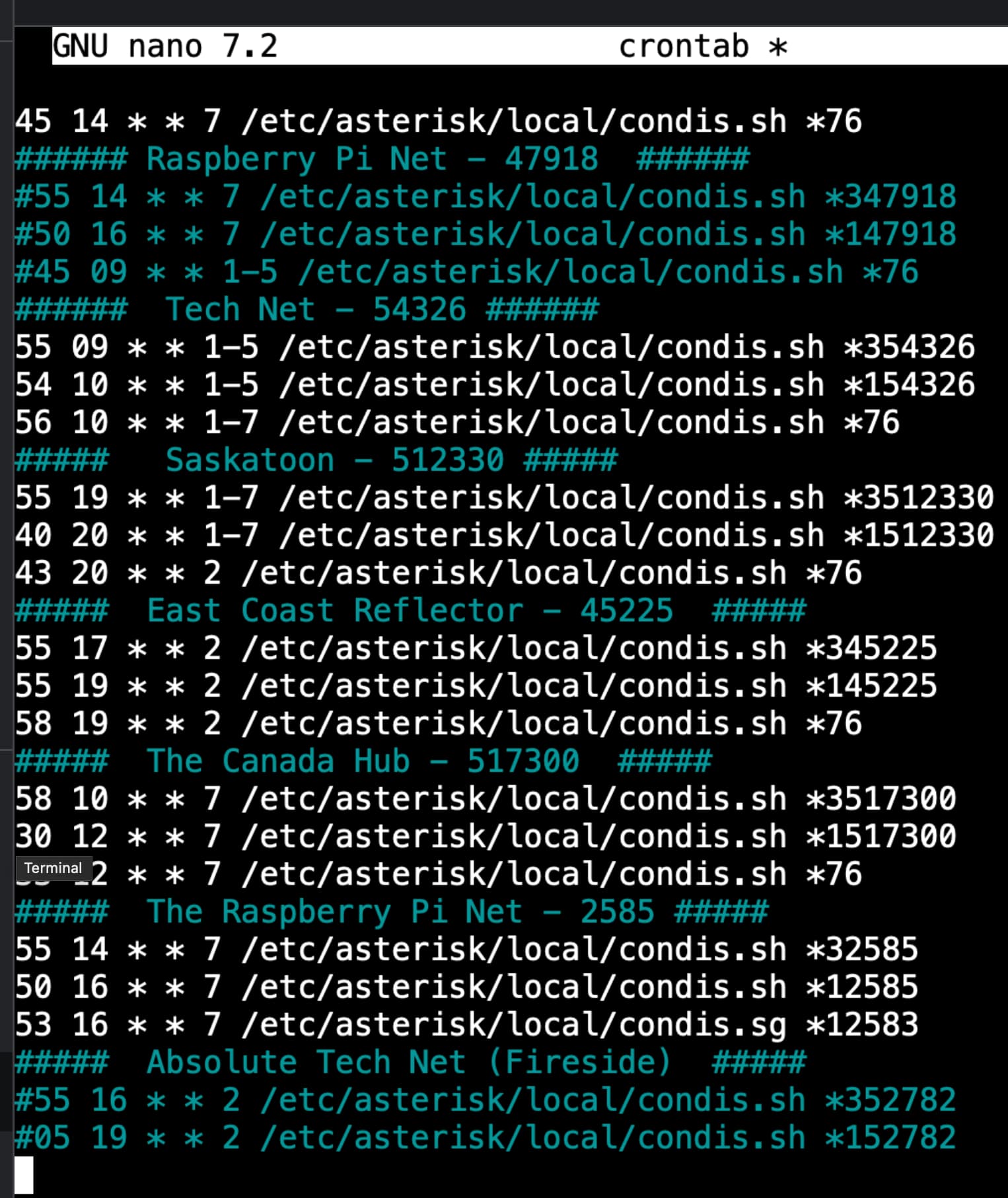

there is a lot better way than using Macros if you want to you can do it thru the crontab -e for your scheduling and use a file that I have to do so. it will allow you to send connect and disconnects without worry of the scheduler in the rpt file and it is really more simple than you think
