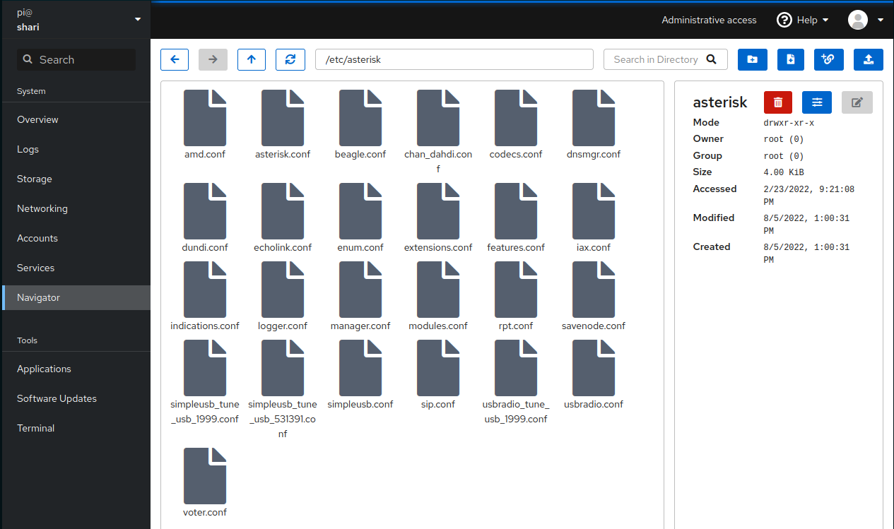

By the way, maybe this is a good time to mention I recently found out about a webpage-based server administration tool for Linux called Cockpit and have been trying that out. You login to the webpage with the username and password of the raspberry pi, and from there you can restart the node, check resource usage and services, etc. There’s also a shell for typing commands.
There is a plugin called cockpit-navigator that does file browsing and file editing from the web browser as well.
All of this just means that to administer the headless node this way you don’t need WinSCP, Putty, or even ssh necessarily. All you need is a web browser. And the user interface looks way nicer than the windows tools.
Here is a screenshot of the Navigator:
