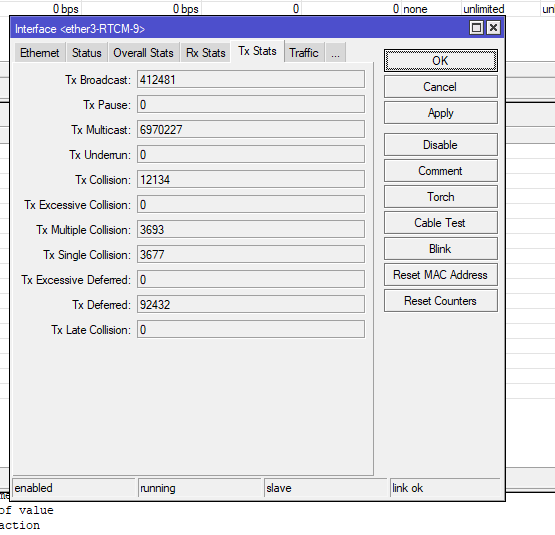

RTCM Inbound (Eth Rx) packet out of bounds
I just checked my log and I have had the Voter lost master timing source message 14 times since November 16.
A few times have been in quick succession.
I run just the one RTCM for both the radio and the master timing source on the network. I haven’t had any out of bounds issues though since moving my system to the mountains, it’s been working flawlessly.
I’m using a Mikrotik RB2011UiAS router.
I have my Pi (asterisk host) set on Auto negotiation and it’s connected at 100mbps full duplex. The RTCM/VOTER board I’ve switched off auto negotiation and have it at 10mbps and half duplex.
In addition the the error messages I have the occasional transmitter drop out… no hang time, just instant tx off in the middle of a transmission. Fortunately it’s a very short period of time. It could be the 5.7 Ghz hop from my server to the hill… maybe DFS but I’ve seen no evidence of any issues with the Ubiquiti radios.
I have the same router as you, Hayden. I’m going to set the switch port for Full Duplex 10Mb (right now it’s on auto) and the RTCM to full duplex and see what that does.

Following Bryan’s directions I’ve changed my RTCM and it’s switch port to 10Mb full duplex. There were TX collisions and other errors on the RTCM switch port before the change.
The server was auto set to 100Mb full and is running error free.
