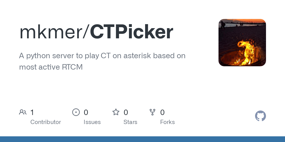

There is a way to do this. With a bit of programming and this python api: asterisk-ami · PyPI , you can access the internal voter data.
On the K8SN repeater, we measure the time each voter is active, then play a CT for the longest active receiver. We also disable the internal CT, and use the python script to manage CT’s.
I never intended to distribute the CTPicker, so it’s a bit of a programming mess. Your welcome to give it a try on your system with a bit of work :slight_smile:
Our version includes deciding which Hall voter channel is active on RTCM (if it wins), or which RTCM voter “won” if not the hardware voter RTCM.
