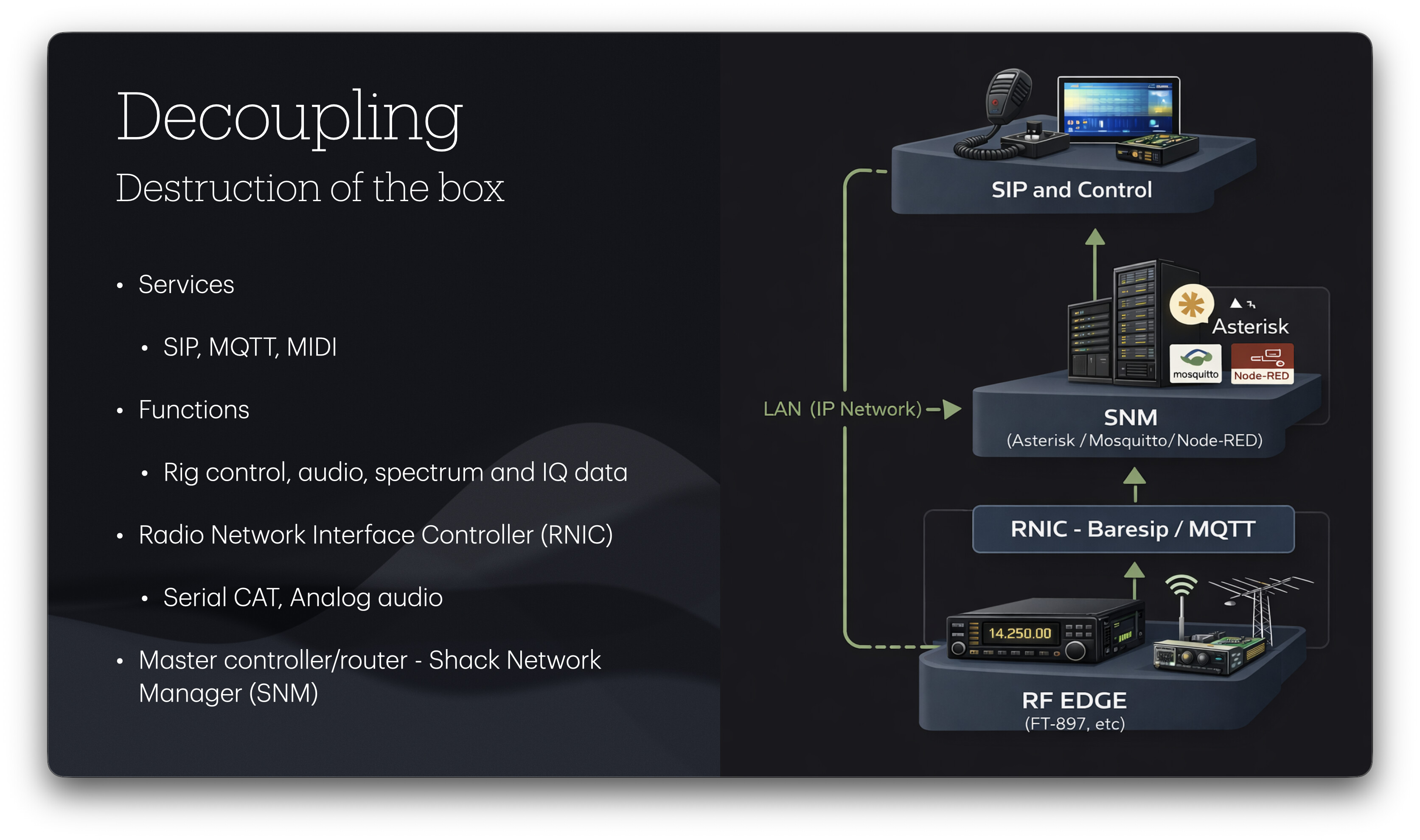

have you considered creating block diagram(s) and descriptions in modest detail of your creation?
(for the benefit of those who wish to explore your clever possibilities)

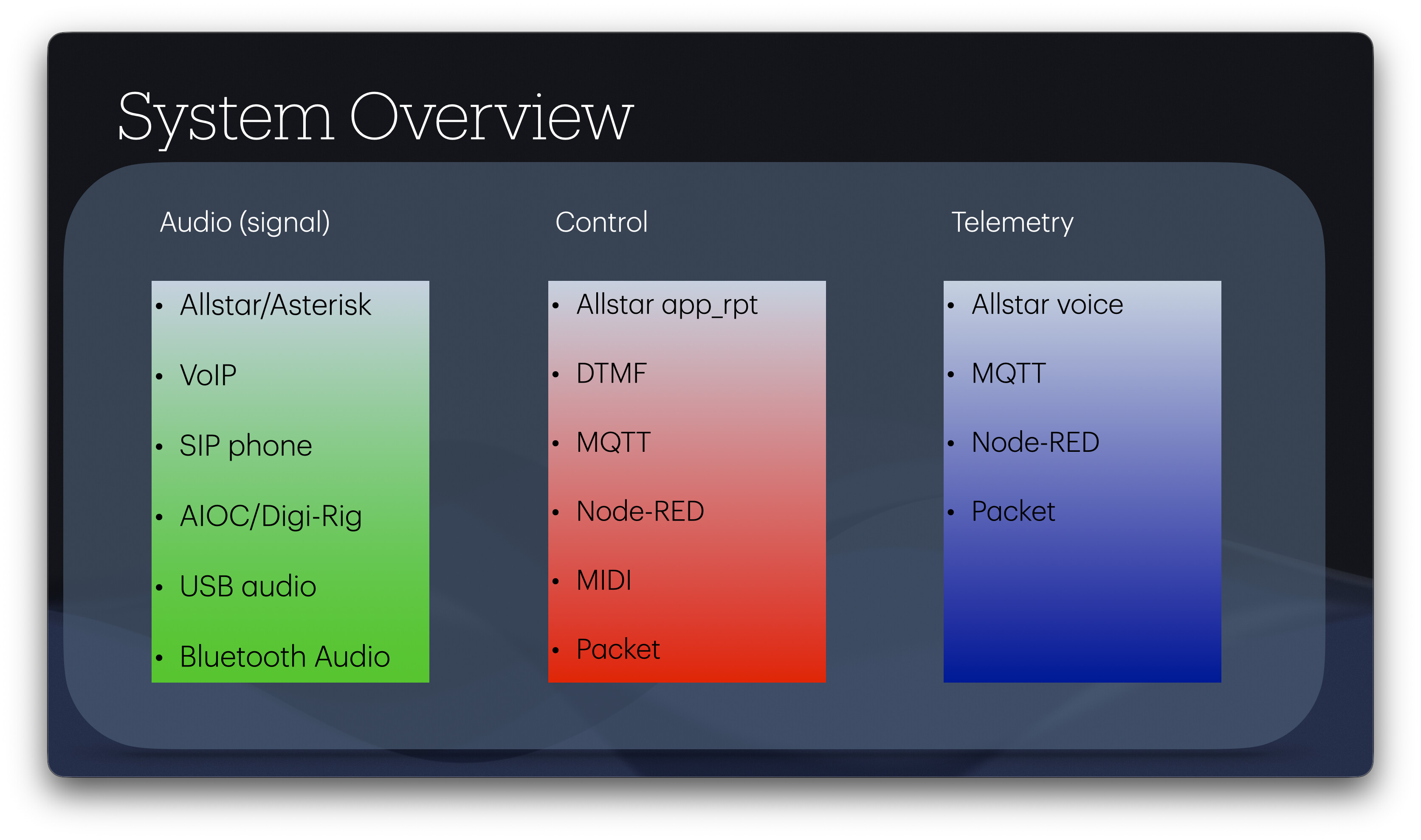

These two slides are from a teaser presentation I did for the local radio club last month. I've been dancing around many of these ideas for several years now, starting back in 2016 trying to operate an HT that was mounted on a drone, later rack mounting my IC-9100 (making it nearly impossible to use interactively), and the untimely failure of our club repeater's PA leading me to revisit Allstar to use the repeater from my house. A lot of what I'm trying comes from my old job working for telecom companies where it was pretty rare to have any controls on equipment front panels, usually just power and "trouble" lights. Everything else was done through PC interfaces. The other motivation is from running audio workstations with MIDI control surfaces and Streamdeck buttons. There's really no need for complicated front panels on radios anymore (even Icom has remote software and controllers), but there needs to be an easy to roll out standard. The next step in the project is to get an ESP32 radio interface that can handle SIP and CAT/MQTT translation. The idea is to get all my radios on the switchboard and able to cross-band each other, reach any radio from a SIP handset and be able to "conference" phones and radios at the same time. The audio part is pretty easy thanks to Allstar/asterisk. Control is getting there with MQTT and eventually NodeRed.
There's a whole lot more work I have to do on this project but the basic framework seems to work pretty well and doesn't require any exotic hardware or software. I don't want to hijack the thread so I'll shut up now.
