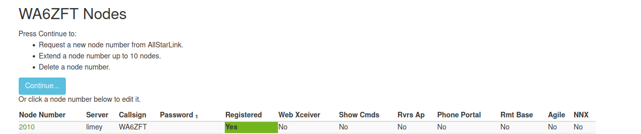

On the portal, I'm seeing a successful registration as well:

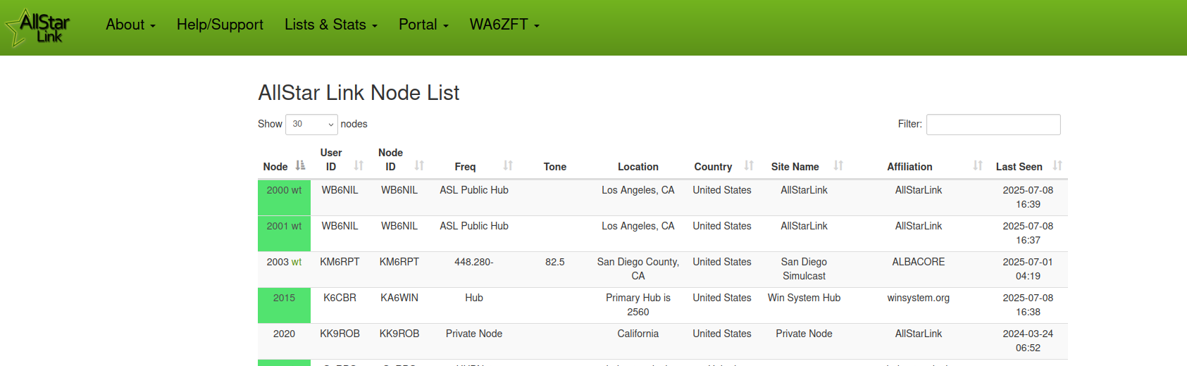

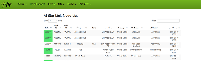

But I'm not seeing it appear in the nodes list on the portal:

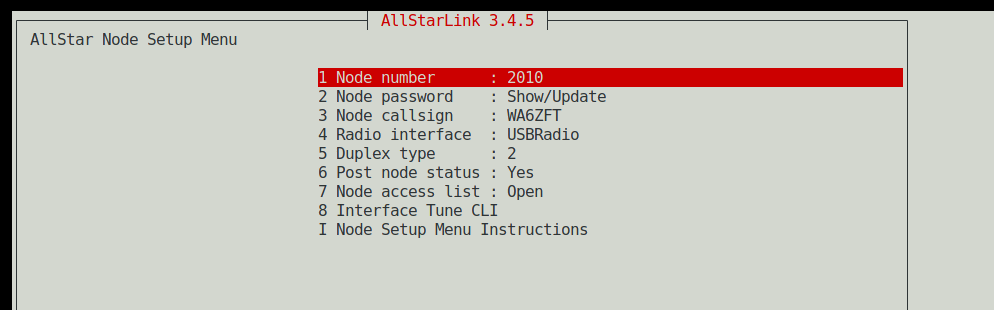

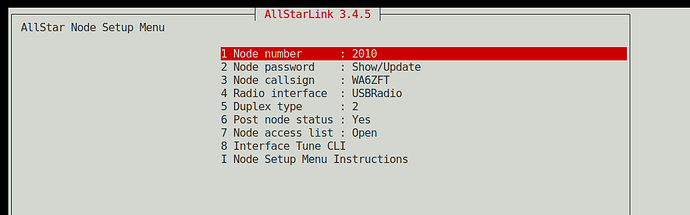

Have you enabled node status posting?
You can check the status for your node with the asl-menu's "Node Settings" / "AllStar Node Setup Menu" / ... / "Update node"
Yes. Status reporting is enabled.
