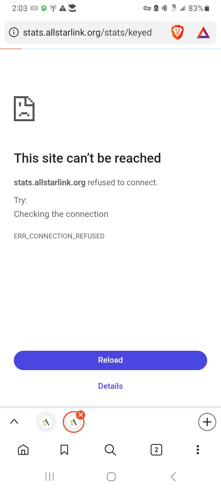

Refused to connect from AllStarLink keyed nodes
Has anyone received "refused to connect" when going to the allstarlink keyed nodes link?
Without knowing your IP or anything, I would expect you got rate-limted for too many requests within the interval.
Especially if you have something like Allscan hammering the stats API from behind the same public IP.
OP is on LTE in the screenshot, but has a VPN enabled, so it's reasonable to assume that they might be routing traffic through their QTH or other location where there is an Allscan instance.
I am just going to the website after hours or days and thatw is what I'm getting. No node running or anything else hitting that website. That's why I think something is wrong???
There's nothing wrong with the service. What's your current IP address? https://www.allstarlink.org/myip.php
Currently the ip address is 24.173.215.166
The site is working right now. I'm letting it update the page on its own.
Something from that IP called "Dart/3.11 (dart:io)" has been hammering on the stats server constantly and keeps getting rate-limit banned. Assuming it's related to dart.dev it looks like some AI coding assistant maybe? Anyway, that's your problem.
