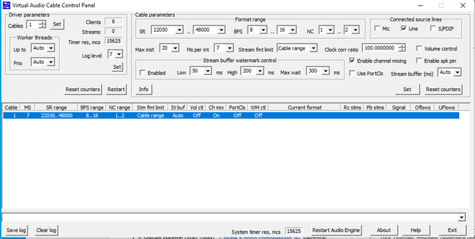

I can deal with Zello, Zoiper, & Allstarlink, but Virtual Audio Cable might as well be Greek. Any direction you can provide on the configuration of the Virtual Audio Cable program would be most appreciated. The project is to establish a private Zello chanel to link into my allstar node. DVSwitch has too many shortcomings & I’m trying the Zello route as an alternative. Thanks in advance for any help you can offer.
Don’t know if this will help you but here are my settings to create a “Line 1”. Then your apps can talk and listen to it.
Much thanks; it is so very much appreciated.
