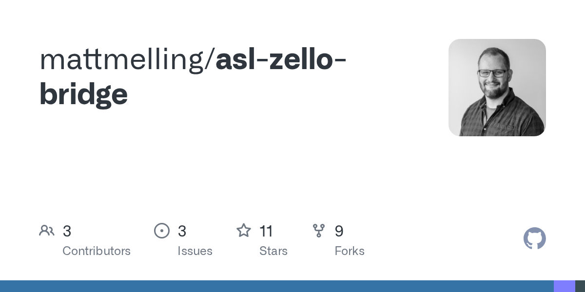

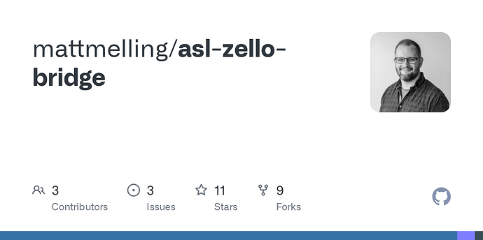

Neat discovery! You'd likely just want to "connect" to Asterisk/app_rpt via USRP, using the existing chan_usrp channel driver. You can do this easily with a little bit of script.The documentation around chan_usrp is extremely poor, but there are other people that have used it.
I recently contributed to this project, which makes use of a lightweight Python USRP bridge to Asterisk/app_rpt, and might serve as a starting point for anyone who wants to work on this.
