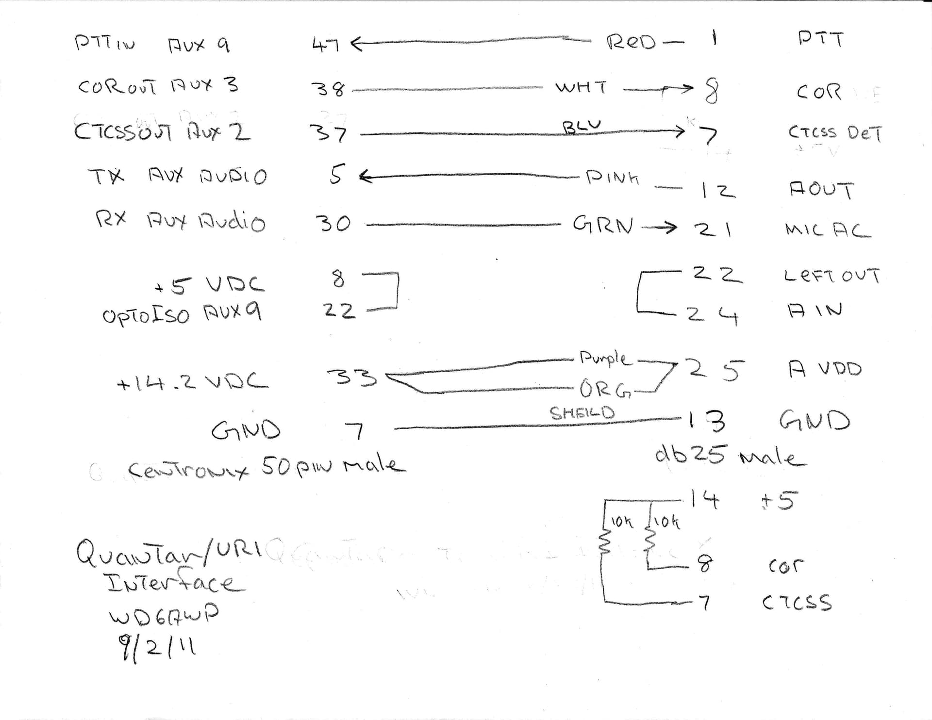

I am working on interfacing a Quantar to an Allstar node for a local group. This is my first time playing around with the Quantar as we usually used MTR2000’s. I have found the article by Adrian Ve7NZ’s but his sample codeplug for the repeater link is broken.
Does anyone have a codeplug I can take a look at ? This is strictly analog.

Interface wiring for Quantar 50 pin to URI
and RTCM.
RTCM 2 Quantar.pdf (286.1 KB)
Also checkout Quantar - W9CR
Adrian reached out a couple hours after I had posted this. Thank you both. Quantar is wired up to the Pi and sounds good.
