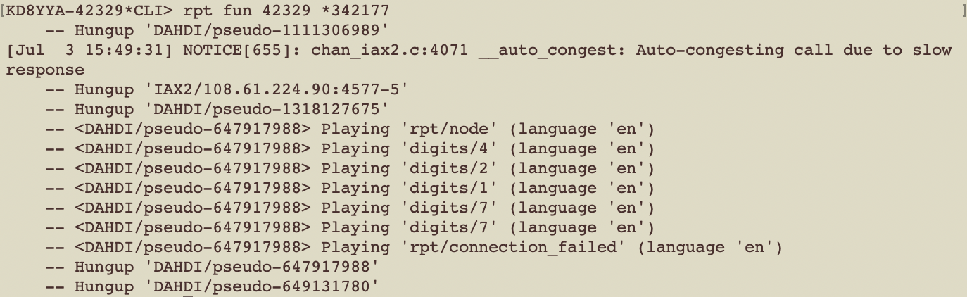

Working on my dad’s node. Both nodes are on their own unique virtual servers, with only a single instance of ASL running. Both nodes have port 4569 open. Both nodes are reporting. But I can not connect them, no matter which one initiates the connection.
Any advice?

If these servers are behind a NAT router you need to do two things:
  • Use different IAX ports, 4569 on one and 4570 on the other.
  • Make sure you have the other server’s IP and port in the [nodes] stanza.
https://wiki.allstarlink.org/w/images/0/0c/ASL_two_servers_one_netwrok.pdf
At this point I will try anything, but I thought that was typically only done when setting permanent connections and usually with private nodes? Have I misunderstood?
*EDIT: The reason I bring this up is because I am not trying to permanently connect these two nodes. But I can’t connect using 3. It feels like the same errors that one would get from port issues.
Thank for the suggestions Tim. Setting the separate ports didn’t do anything on it’s own, but after adding 42177 = radio@108.61.224.90:4569/42177,NONE to dad’s rpt.conf and 42329 = radio@144.202.65.131:4570/42329,NONE to my rpt.conf I was able to connect 42329 > 42177… but not the other way around… Some progress is better than none, I am satisfied for now.

Recheck your settings. I pretty sure the wiki document covers all the changes.
Remember to point each server to the other’s IP and port. Also be sure to change the port in iax.conf and rpt.conf of the server with the changed port. in iax.conf the bindport needs to be directly below the [general] stanza as shown. Restart asterisk on both servers after the changes are made.
Not related but you must change the server port on web-tpa.allstarlink.org in order for external nodes to connect.

I asked about the IP because I was trying to help you figure out if these are being a NAT router or not.
If in a data center maybe not. If the servers have different public IPs you shouldn’t have to do anything special. Just set them like a regular node.
Only servers that share the same public IP need to be on different IAX ports.

Because those are both public IPs they can be the same port or different ports, your option.
