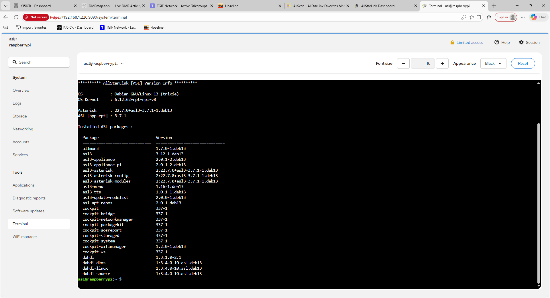

Use sudo asl-show-version to obtain this information from the console or SSH
Asterisk Version: 22..x.y+asl3-3.n.m
ASL3 Version: 3.x.y
Inquiry
See https://allstarlink.github.io/user-guide/troubleshooting/ on how to ask a good question to obtain the quickest and best assistance
Any idea? Audio settings? conflict somewhere?

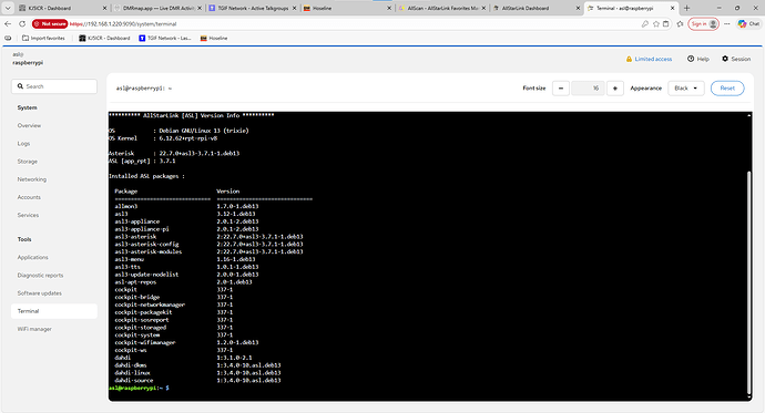

22.7.0+asl3-3.7.1-1.deb13
3.7.1
