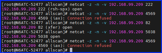

hmmm… I got this:
netcat -z -n -v 192.168.99.209 4569
192.168.99.209 4569 (iax): Connection refused
This is odd, because I know how to forward ports in my router (Ubiquiti UniFi UDM Pro) and I’ve checked it over and over and it is configured like every other open port that is working correctly.

It looks like there is a problem connecting through that port. So I’m looking into it.
