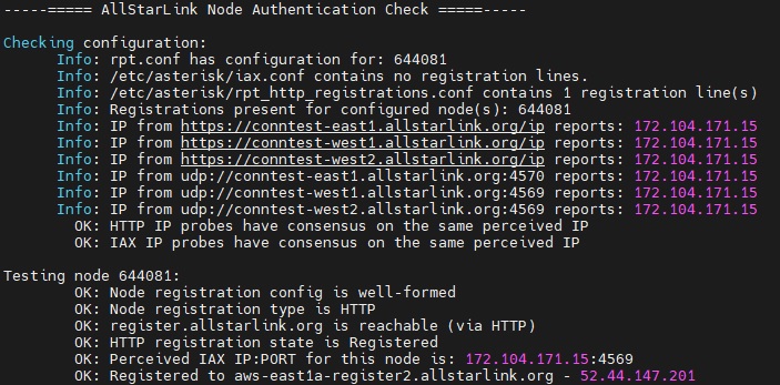

I’m using a AllStarLink Node using Linode Cloud Server, Debian 12 OS and Allmon3. It shows currently registered in my Node Settings but my Node i.e 644081 is online but is not reporting statistical data.
I understand that this is similar or same to other topics however I tried all instructions but in no avail.
Maybe I overlook some Instructions...

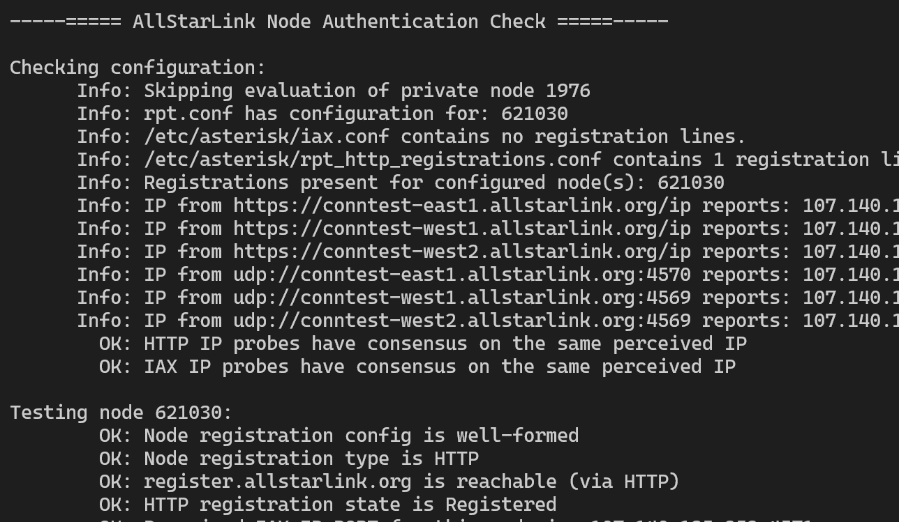

I also upgraded my 621030 node to Debian 13 (Trixie), hoping the latest version would resolve the problem, but it’s still not reporting. I also verified my node password is correct in the rpt_http_registrations.conf. There are also no errors when I perform asl node auth checks Both nodes are otherwise functioning perfectly they’re just not reporting back to AllStarLink.

I also performed asl-node-auth-check and come up with the same result as you;

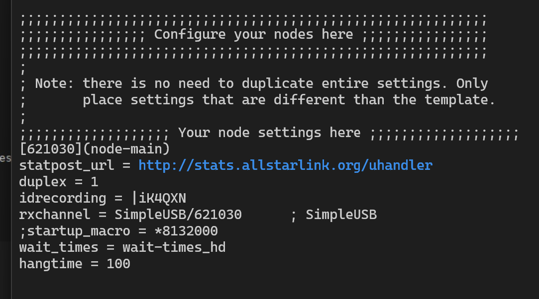

Do you have ‘statpost’ properly configured for each node? This is in rpt.conf.
Thanks for responding N8EI. I do or what I think should be correct.
Hrm. Interestingly on the stats size, you're getting back an error of unauthorized. I see more of that than I should. I wonder if the stats system is locked up somehow. Looks like it's time for a restart.
Well, this was an interesting one that didn't come up in beta testing because I never thought to look... The newer version of Asterisk is now preferring IPv6 over IPv4 for all HTTP calls. Thus systems with IPv6 addresses were now choosing that causing a register-vs-actual IP mismatch causing the statpost to be ignored. I pulled the IPv6 address off the DNS name (which is sad). Sadly, fixing all the problems with statpost is not backwards compatible. But at some point we're going to have to rip off the bandaid as well.

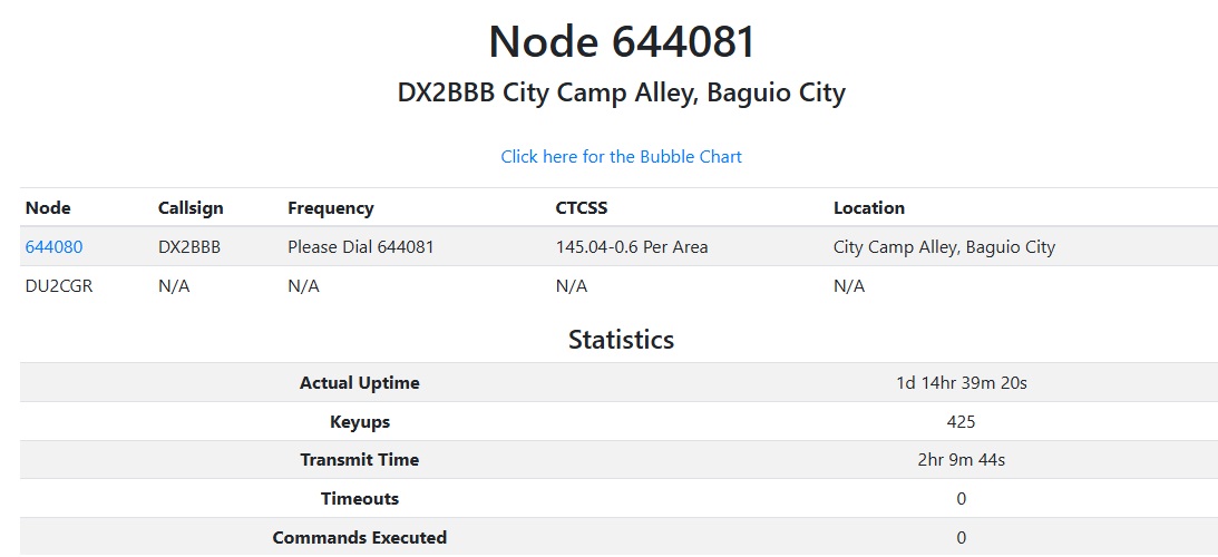

Thanks N8EI both node are online reporting now. I tried everything from my side to figure this out with no luck. Glad Raymund and I were able to help you find a potential flaw with the IP mismatch. Sorry to hijack your original post Raymund! 73’s from K4QXN
When I check my Node Status now... Guess what? It automatically FIXED itself without doing anything. It seems that it is solved automatically by itself!!!
I will observed and update you K4QXN and my 73...
