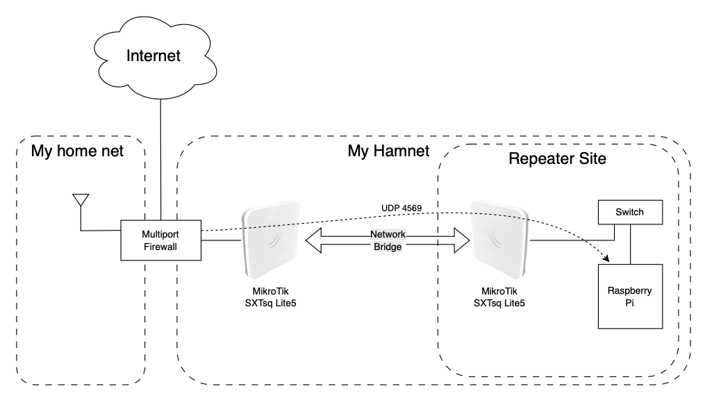

I’m using a pair of Mikrotik SXTsq Lite5 devices to make a wireless bridge to the node. It’s at my house right now, but I will be using it for a repeater link where there’s no Internet. I had assumed the bridge would be transparent and just send all packets back and forth. Never assume anything.
Your comment got me re-thinking things, and I started isolating the various bits of the network. When I replaced the wireless bridge with a cable, the connection stayed up. That got me Googling Mikrotik bridges and it turns out it runs RTSP (real-time spanning tree) at intervals to prevent routing loops. There are no loops in my setup so not sure why this was a problem, but disabling RTSP fixed the issue and my nodes remain connected in perpetuity.

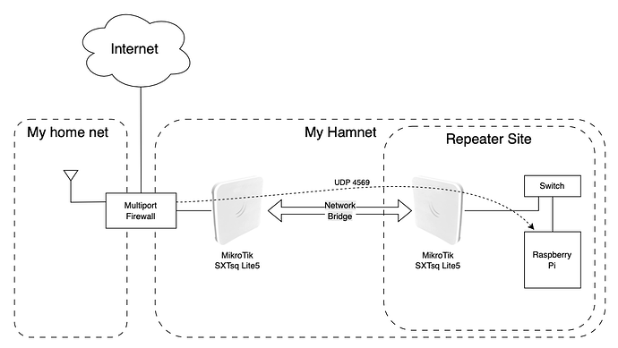

I wholly respect the importance of spanning tree in detecting network loops. But the network is pretty linear and there is little chance for loops:
I don’t see how a loop can exist. Even if the Raspberry Pi had WiFi enabled (it does not) that would connect to the home network and get an IP on another network and not constitute a loop.
I’m no network engineer so I accept that I could be wrong about this. Do you have suggestions about where I should look for evidence that there’s a loop?
