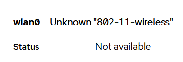

I tried two different versions both have RFkill soft on.
if I plug a usb nic in it gets an ip address.
In the wifi manager in the portal I get
Available WiFi Networks
WiFi scan failed

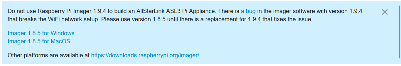

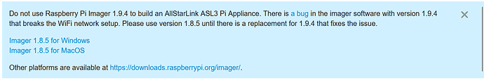

I may have solved the problem when I posted i saw this. I AM using 1.9.4 for sure. I just checked
Update : This did not fix my problem I am running imager 1.8.5 and still the problem persists.
