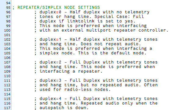

What is your duplex= in rpt.conf ?
Mike, the node is connected to a BCR repeater and it was working fine until I updated the software. RPT.conf duplex=0, SimpleUSB duplex=1. I have another node connected to a 2M repeater with identical settings and software which works fine. When I transmit using the radio, I receive the acknowledgment tone from the node.
Repeater setup should be duplex=2 in the rpt.conf
duplex=0 is No telemetry tones
It would be correct for a repeater that duples mode should be 2/3/4 as needed

Repeaters need to be duplex=2/3/4 in rpt.conf

Set duplex mode in SimpleUSB to 0
Set duplex mode in rpt.conf to 2
save/restart
It should work.
The audio gates for rx and tx need to be open all the time for a repeater. It can not do this under duplex=0 (rpt.conf)
