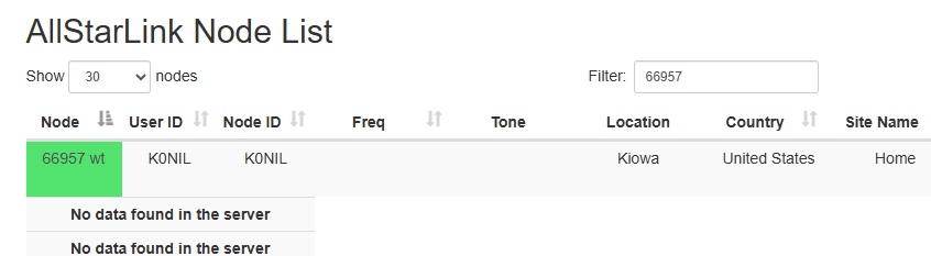

After a reboot, node is showing IAX2 registration, but can’t connect to outbound nodes. a connect to 55553 works fine. Strangely, online “whats my IP” websites return an internet IP address different than asterisk CLI node lookup. A remote user (me) trying to help can’t ping the IP of the asterisk CLI node lookup.
The node shows up in allstar as registered (green) but not reporting data. The asterisk CLI is reporting statposts failed with an error of 401 (unauthorized).
We’ve doublechecked all the changes to the config files required for IAX and everything seems to be all fine. Triple checked the node/password combo in iax.conf. I don’t believe this is a password problem as the node is showing registered (although I really don’t know that for sure).

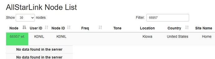

And the green registered status on the Allstarlink.org webpage nodes list being green and registered but with NO data make no sense.
