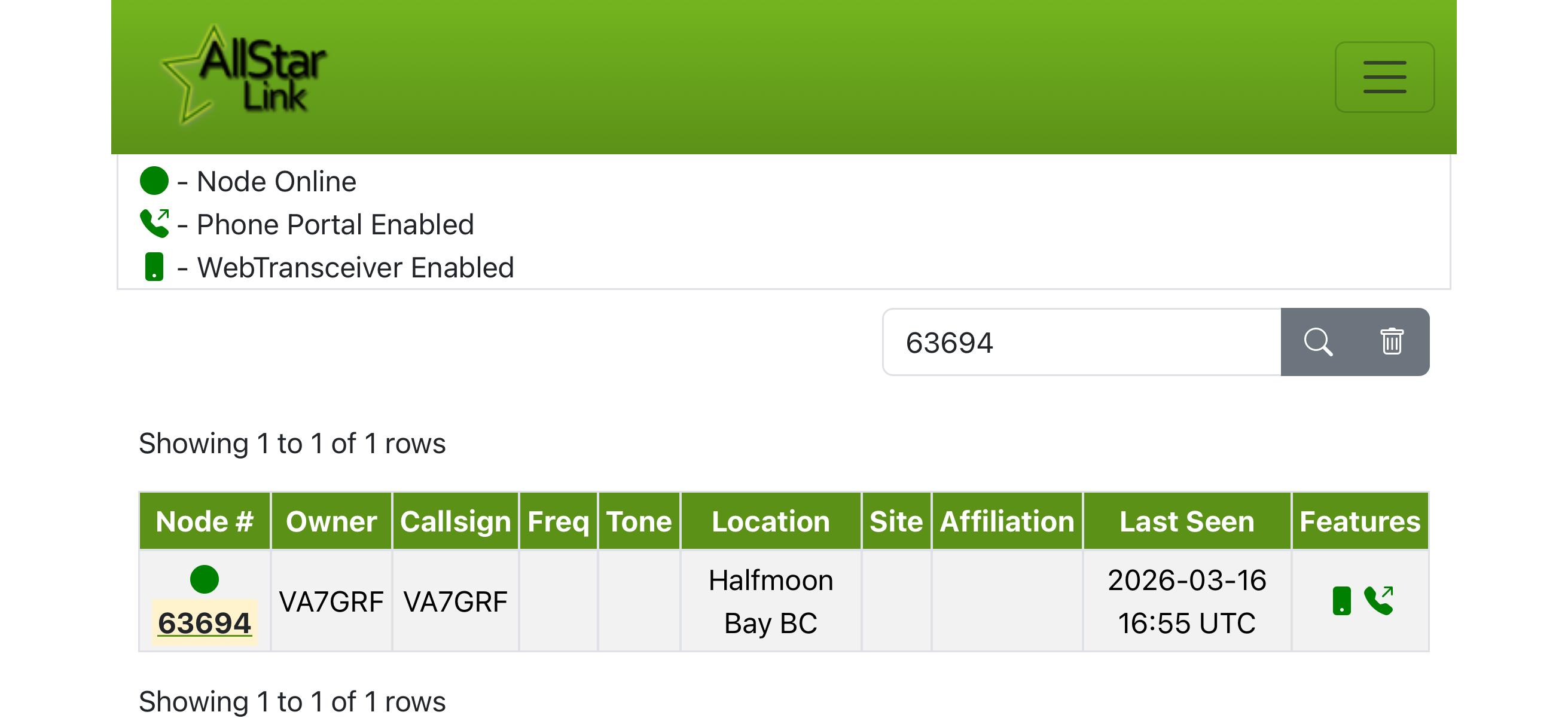

no joy when trying to connect to 63694
there is Administrative Access elevation you should do for Cockpit, and you must also use the Login button for allmon3
also not seeing 63694 in Searchable Node List
I have Administrative Access on for Cockpit and I am able to use the login button to login to allmon3 but still can’t use it to control the node. I can see it in the node list.
wasn't there before. is there in Searchable Node List now. still no joy when i attempt to connect.

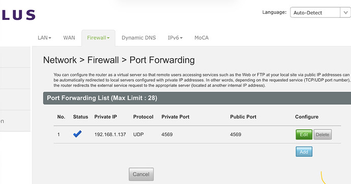

Could my ISP be blocking it. I did confirm it’s set up correctly in the router admin interface.
as it is right now, you can connect to nodes like 55553 (Parrot+), right?
it's just no node can connect to your 63694.
Can you tell us a bit more about your network configuration? Who is your ISP? Are you using your own modem/router? or one provided by the ISP? or your own router plugged into the ISP's modem/router?

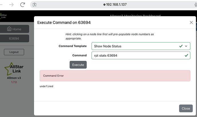

I can’t connect to any nodes or parrot+ i just get an error from allmon3 “Command Error”
ISP is Telus. I am using their modem and router. I am able to login to the admin portal of the router and change things as needed.
Does the modem/router show the WAN IP as 75.156.122.62 ?
... and the IP address of your node is 192.168.1.137 ?
Yes WAN IP shows 75.156.122.62 and node is 192.168.1.137

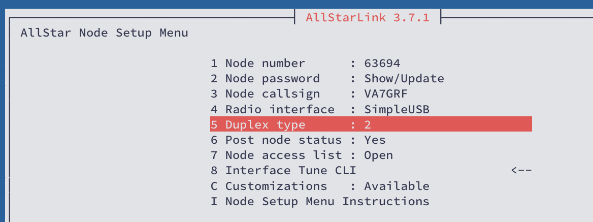

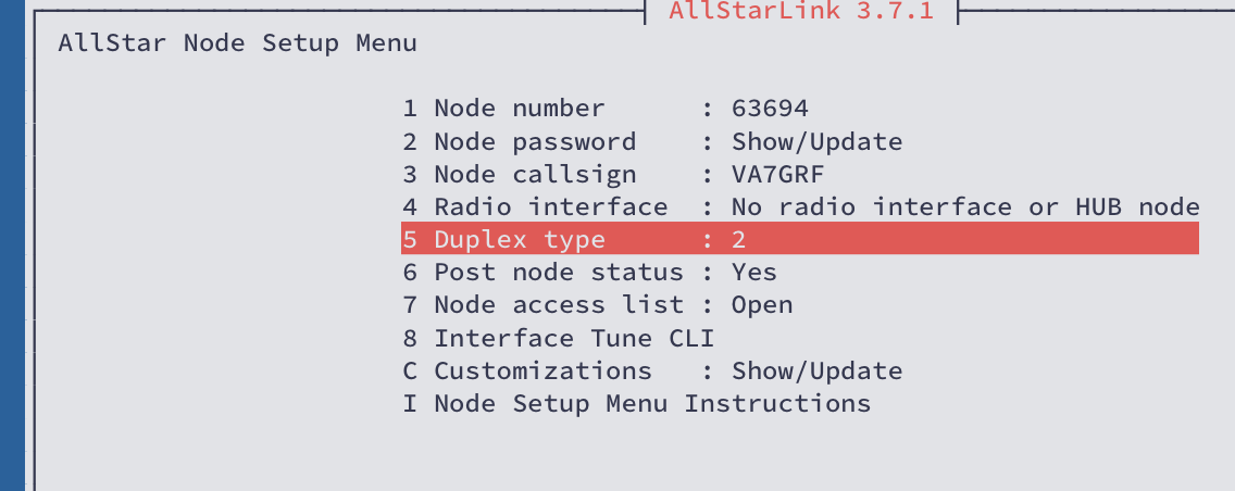

Since this is a 3.7 host, please run asl-check-install and confirm your settings in asl-menu. Usually that original error is saying that particular node is undefined when you tried to run the command. Does the command work if you select show uptime?
I did install with asl3-appliance-pc
This is what i got. Seems that it does have a firewall and active zones are allstarlink

asl-menu seems ok - i can’t seem to figure out how to change the duplex type but not sure that matters?
The repeater is not starting because you don’t have a USB device connected. If you’re trying to build a hub without a USB device thing, you need to use the pseudo channel.
Thank you - I changed it to “no radio interface” it still shows duplex type 2 and wont let me change it. I even tried deleting the node and adding it again. I then restarted asterisk and rebooted the server. Still no beans :sob:
I have realized that whatismyip and my router wan show different up addresses which makes me wonder if it could be a cgnat problem …. :thinking:
