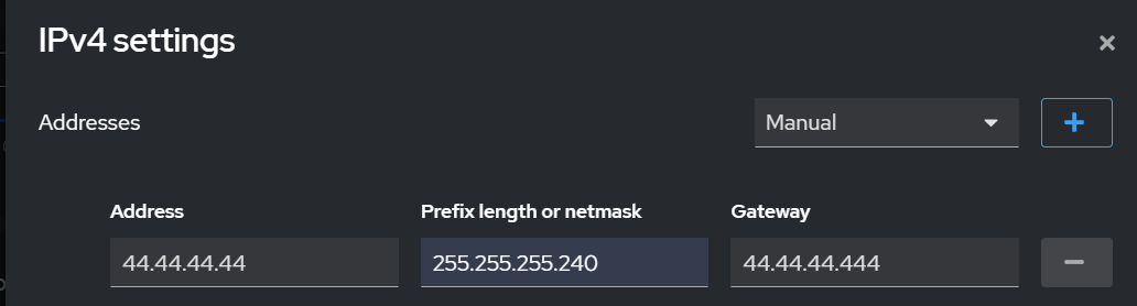

Back to the drawing board! Using these methods, I get the ASL3 Pi to connect to the router. I can connect to the ASL3 node dashboard and can SSH into it to make changes. But, it is not being registered to allstarlink... I can use allmon3 to connect to a node and it says, "OK," but no connection occurs.... I have a Hamvoip node connected to the same Mikrotik router for years.
Can you provide the real information on what you're trying to do? That screenshot from Cockpit can't be valid so I'm assuming you masked your information.
44.62.14.115 if you want the password, email me
No, I don't need the password. Looking at the AMPR registry, you're assigned 44.62.14.0/24 and you're advertising out of Vultr? If that's correct I'm assuming then that you're tunneling some smaller portion back to your home or some other location? There's nothing special about the ASL3 Pi Appliance that wouldn't work with 44Net - many are. As long as you have your address, netmask, and gateway set in the ASL3 Pi Appliance then your network should be doing the rest. I've run many devices on a 44Net tunneled address space with no issues and, coincidentally, also using Mikrotik RouterOS.

I knew your call sounded familiar! When you go to "Networking" in ASL3 to change IP addresses, after the change it will test the ip address. If it fails to find the new ip address, it will attempt to go back to the original (DHCP) address. That is where you get the "Reconnecting" message.
