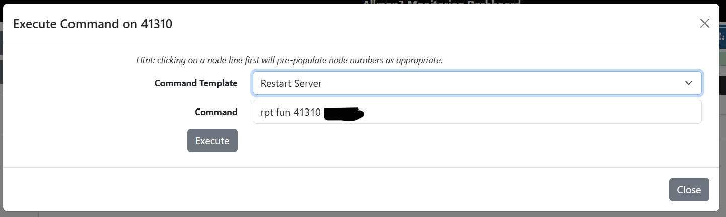

That said, I’m trying to create a command that can be executed from Allmon to initiate a server restart. I have a DTMF function I’ve created to perform this action, which executes a super simple script. But, I’m not sure how to write the command for Allmon to execute it from the web interface. I tried writing it as if I were at the command line and asking it to execute a DTMF function, but no go.

For example, let's say you've defined *800 to call the script to reboot the system. Make sure that calling rpt fun 41310 *800 from the Asterisk CLI functions as expected. If that works, then Allmon3 should "just work" because all it's doing is passing the text into Asterisk. Then under [syscmds] in web.ini you should be able to simply have:
rpt fun @ 41310 *800 = Restart System
Make sure you're using the appropriate helper scripts.
