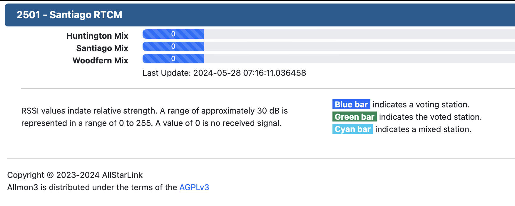

The single node way is similar to a 420 linked system. Touch tones pass thru a mixminus setup. This is ideal if you like having (an old school hardware) controller at each repeater with AllStar connected to a second port. Of course mixminus setups will work w/o controllers as well.
Here how my mixminus setup looks on the Allmon3 RTCM display.

The separate node way allows the repeaters to operate in more of a standalone mode. Each repeater can be functioned separately in case you’d want to separate one repeater from the others for a net or something.

[2] Regarding the Allmon3 RTCM display…
Is this already built-in to Allmon3? (I have it installed.)
